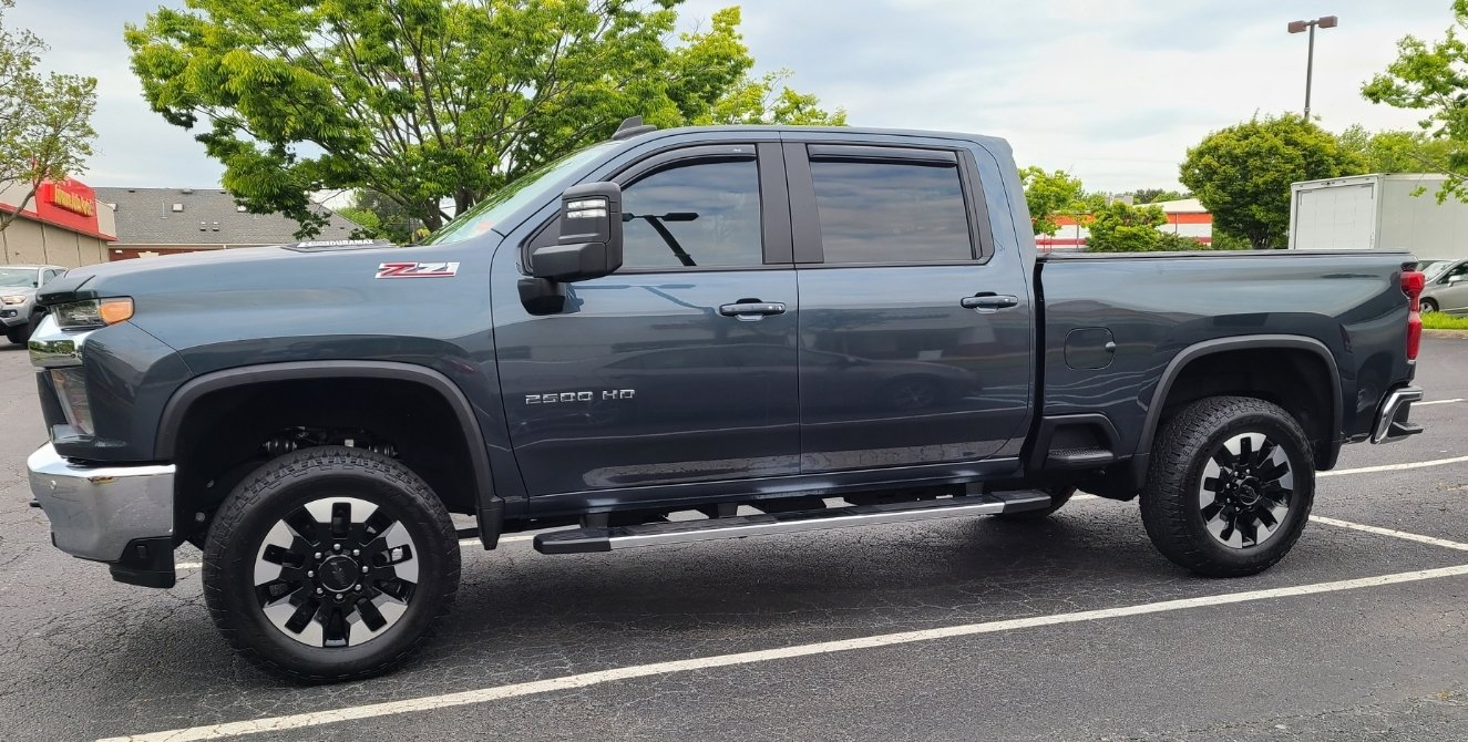

I turned the stock keys up on my new 2022 2500hd and the 295/70r18 Micky Thompson’s fit fine
