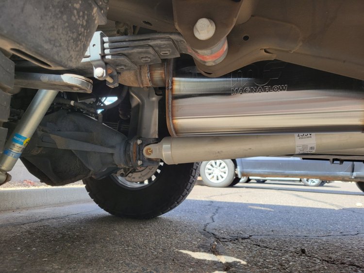

Offset/Offset or Offset/Center? 5x11 case? (I think magnaflow makes a 5x8 as well).
Was doin some dig'n, there is a enough room on the tail pipe (where it starts down after coming over the axle) for about a 9" resonator. I may go that route. Was looking at this one.
Apparently, the Vibrant Ultra Quiet comes highly recommend across the web.
Also, proper placement is between the muffler and cats from what I've read. After muffler at the tail pipe does nothing for the drone reduction goal.

I have a Gibson single exit kit on order, supposed to ship around the 3rd (tomorrow).I’ll share my experience post install.
Put the Vibrant on.
Did the trick. Pretty much stock silent inside at very low throttle cruise. No blaring drone through the range, just mellow exhaust tone now. You can hear it has a muffler on it but it canceled out that specific bass frequency that was driving me nuts. Made no change to the exterior tone or volume, still sounds mellow and moderate like it did before.
  • Like 3
I’d like to have had some feedback on the Gibson cat back I have on order but that have yet ship it out .Gibson says they had been waiting on material, then were waiting on fabrication..been weeks.
Finally got the kit on, sounds great, zero drone.It is for a longbed and does require a cut and relocation of one hanger if you are fitting to a short box.
