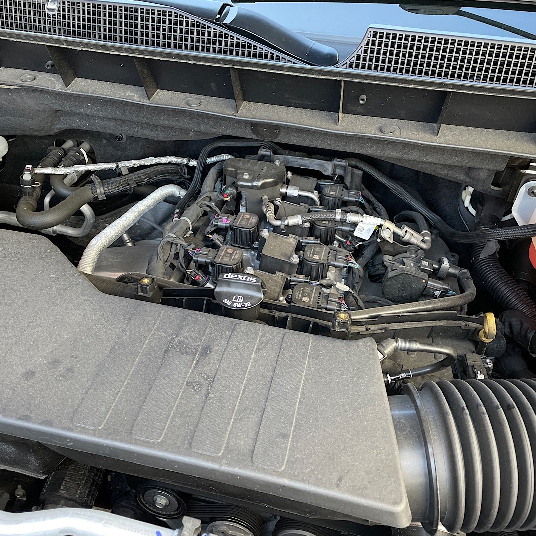

I’ve had a rattle/vibrate on my dash around 1200RPM since I got the truck. I took it to the dealer and after a week they said “this engine is just rough”. So I narrowed it down to the engine cover. I took that off and poof the vibrating is gone.
I’ll try to re-seat the cover eventually but I have to take it off when my intake gets here anyway. For now it stays off.

Any word on if it vibrated after you did the reseating?
 Nope, it's 100% fixed.  Took the engine cover off, put it back on (make sure the back pieces click on (toward the firewall), then tighten the 2 front bolts down good.
