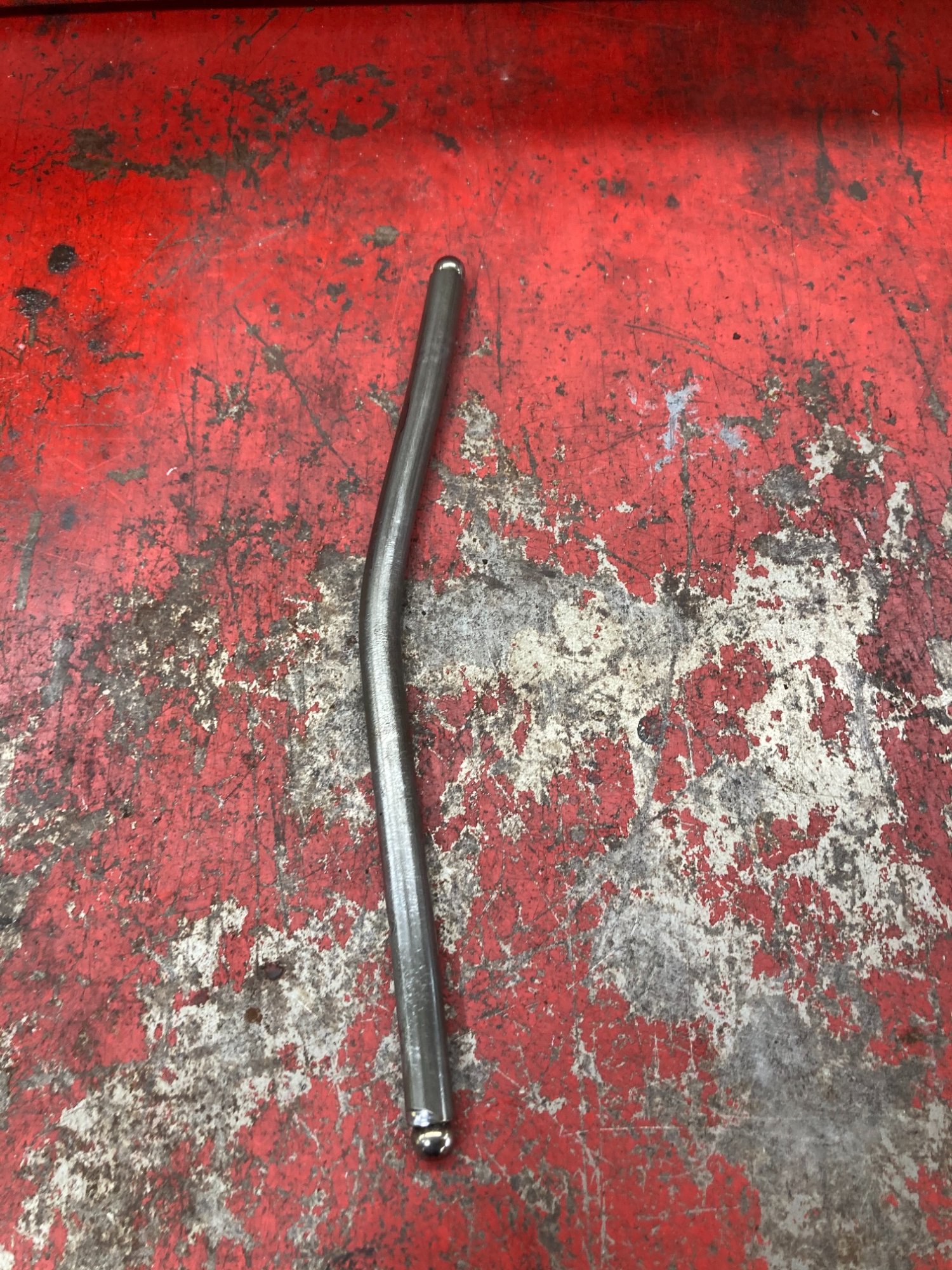

Did my first 2015 6.2 L86 cam job. Came in with a dead cyl #4 and a bent push rod
   65k opted for new factory cam/lifters/vlom replacement.
took s few days to round up all the parts.  Alldata say 30hrs
   Sure felt like it. I worked on it over 2 5 day work weeks, few hours here and there. In hindsight should have done a gm reman and be done with it.
    Waiting to see that oil pressure come up felt like forever!
