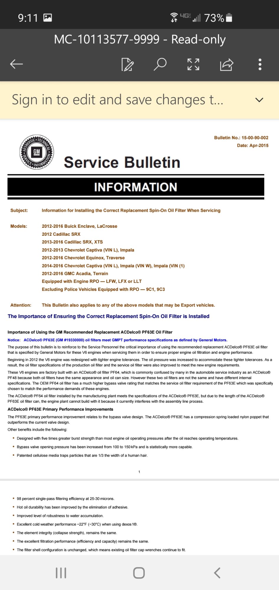

That bulletin is from 2015, it concerns the 3.6 V6 engines, and is telling us dealers to use the longer 63 filter in place of the 64 filter that was used during engine assembly due to there being clearance issues at the engine assembly plant.
It doesn't concern any of the V8 engines, and the part number listed, 19330000, has been changed to 12707246.

Right, I just spent 4 years with dealers knowing nothing about what filter I should use on my 2017 impala. Because of that I don't trust them saying again to use a different filter than my 2021 silverado owners manual says.
