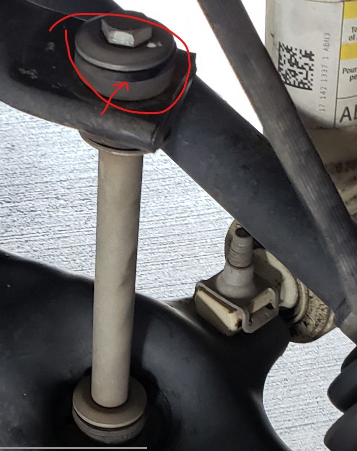

I crawled under yesterday to just visual inspect to see if anything looked worn, or damaged. It almost seems like binding, but like i said doesnt always happen, the only thing that stood out was i believe the stabilizer end link on that side, the rubber was pretty shiny /clean where as everything else was pretty dirty.  Also noticed that one tire is worn pretty low on the outside portion of the tire. The rest of my tires are pretty evenly worn out,
IF that is the culprit, is that easy to replace or tighten? I know ill need an alignment check or done in order to make sure everything is ok, seems ill need new tires soon. just cant afford to do it all at once.. So need to do it one thing at a time..
I've added the part that i believe may be causing the pop, but could just be normal wear that im seeing on that area.

My suspension and UCA's are no longer stock but check out the UCA bolts and make sure they're tight. I noticed a popping noise occasionally when I would turn and 3 days later I got on in my truck and could barely turn the wheel to the right, it was like the electronic steering went out. I got out and looked quickly and didn't notice anything out of the ordinary so I went to work and just took right turns slow. Stopped for gas on the way home and noticed the driver side UCA was shoved way into the engine compartment because the bolt and bushings were completely gone.

Ok so I would’ve bet my life the noise was coming from front end, we’ll it turns out the noise was coming from rear end leaf springs.
installed that “spring things” thing and noise is gone, spent a few hours today going through front end with torque wrench, removed sway bar entirely, etc.
I was completely sure it was front end until someone listened outside truck and walked next to it.
