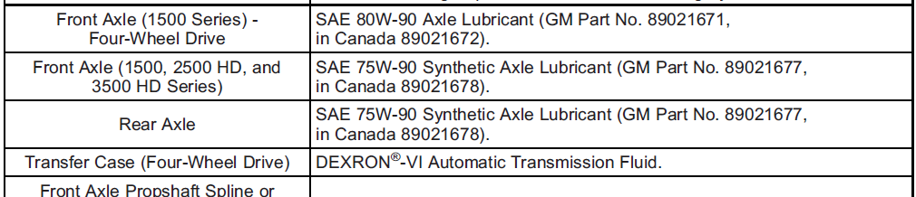

80W90 is long gone.  Even on a 2011 they replaced it with 75w90.  The part # for 80w90 supersedes to the 75w90 #.
So 1500s use 75w85 now.  GM has two different lubricants based on who's manufacturing the axle, AAM or GM.  What the difference between them is other than scent (grape vs. vanilla), I don't know, but both are high efficiency GL5.
HDs use 75w85 in the front, 75w90 out back.
Thanks.
It' wasn't what I typed, but I was thinking they would all be the synthetic product (75W-90) listed in the 2011 OM screen grab.
