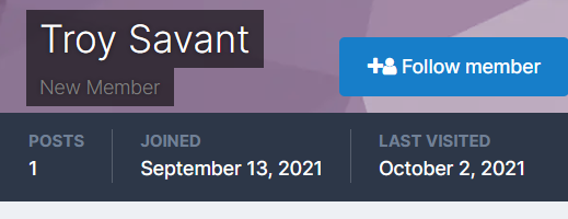

That is the only post he made (sept '21) and he hasn't logged in since Oct '21.
Probably not getting a response.
