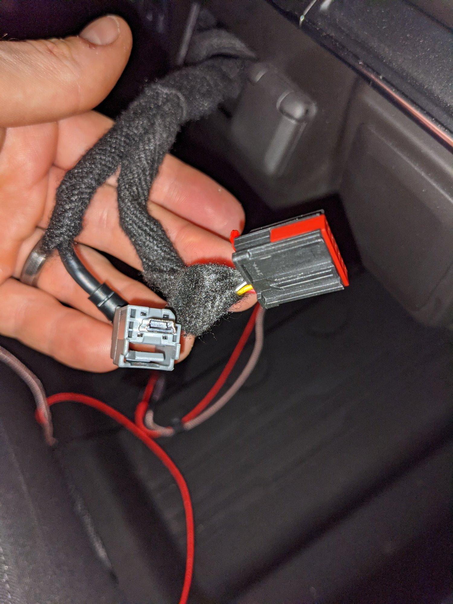

So, I did some more digging.  A 2021 Sierra WT/base fully optioned out has 2 USB ports on the dash - 1xUSB A, 1xUSB C.  I tracked down this part number, and it references a receptacle that has THREE inputs, instead of two.  It has the vehicle harness + TWO USB connections/cables going to it from the radio module.  So I did some digging under the dash - and behold there are TWO USB connections plugged in to my radio module.  Using process of elimination, I found which one was controlling my USB on the dash, and which one was "MIA".  The gray plug that I am pointing to in the picture is nowhere to be found in the dash (by poking around through the USB receptacle hole.  I did NOT pull the dash pieces yet and remove the radio screen/HVAC to dig around more.  Looking at the harness routing diagram, it LOOKS like it should be right in the hole for the USB (if it exists, anyway).
So...a very long winded background story leading to my question.  Does anyone know WHERE the gray plug USB port/cable goes in a darn work truck (single cab)?  If I knew where that cable went (and assuming it went in to the dash), I could just use the second connection and get what I really need from the "correct" USB receptacle.
Pictures attached - anything you can provide to help would be greatly appreciated.  I'd like to avoid pulling apart my dash for POSSIBLY no reason, if someone else already did and knows where to find what I am looking for.  The second picture is just showing what I have currently at the back of the USB receptacle on the dash.  Thanks in advance
