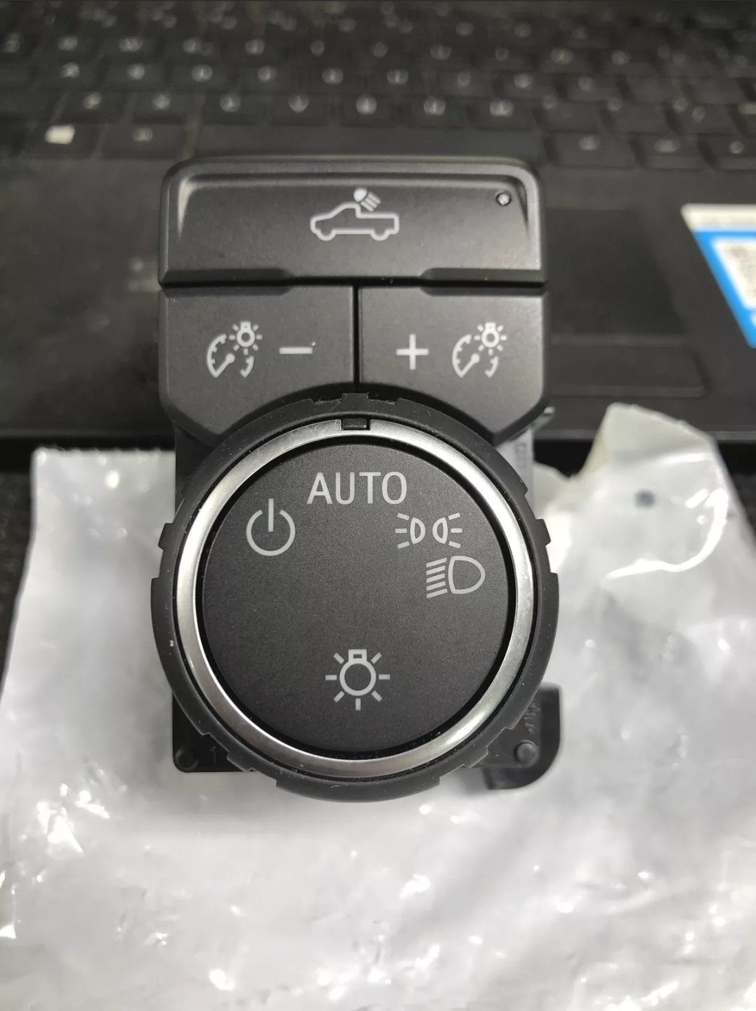

Hello all,
I am trying to clean up my light bar wiring, I am wondering if I install the the GM AUX Switches is there a way to have them only activate when the switch is on and the bright lights are on? Also wondering if there is a way to swap to the below switch, and use the bottom button the on the switch to active the light bar?

Yes with a relay. Have the aux switch control the power for the light bar and power the relay contacts with power from the brights.
I would think it's possible to use that headlight switch. But it's absolutely above my pay grade. I would imagine the bcm would need programmed and then trace out the bcm wire for the bed light. That is if gm uses the same wiring harness for both switches.

I don't think that switch will work.  I'm not talking about the electrical components.  I'm talking about the shape of the box behind the dial and buttons.  Hopefully I'm proven wrong.
