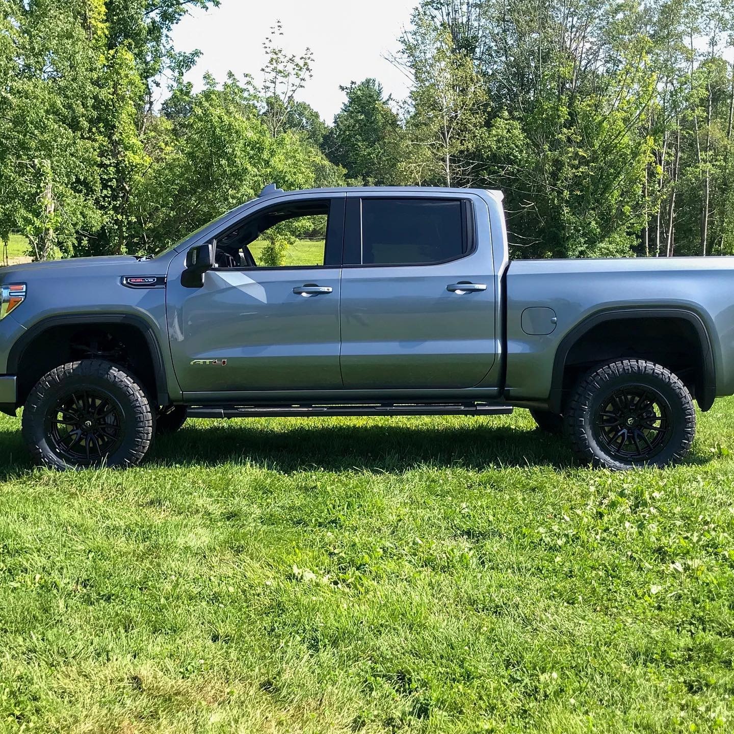

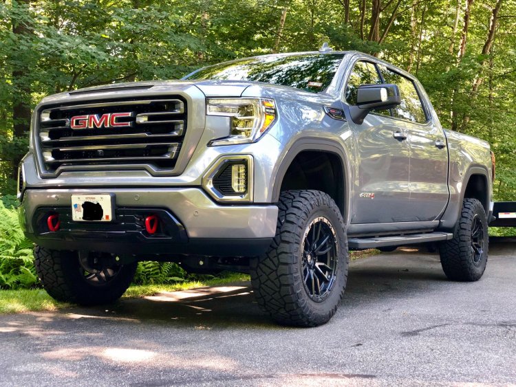

I ran the 4” kit and 35s on my 2019 for a couple years. It’s a good kit, didn’t have any issues, but there was a good bit of trimming required to fit the tires. These pictures are without coilovers, I bought them after the lift was installed but never installed them. Still have the coilovers sitting in a box 🤦‍♂️ but I’ve since moved on to a 2500 AT4.
