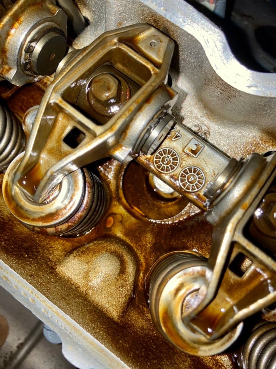

I know I said I was done for the night, but I thought I’d pull the valve covers.  I was expecting some sludge due to the symptoms.  Quite a bit of sludge and some coolant present in the recesses where the head bolts go on the drivers side.  The recesses also look like the castec TSB which was what I was trying to avoid by getting new heads.  Passenger side looks normal, except for the expected sludge.  I think I have a cracked head.  I will sleep on that!05274D65-CD19-4AC8-8540-12FE4EEFC3D9.jpeg.beeb28eead2eac351a3cebbb1b6dc61b.jpeg

Inspected both, one had the areas near the head bolts that looked steam cleaned.  It’s in an earlier pic I posted.  The other looked normal.  There’s a few pics on the web showing this as GM had a TSB on this issue.  Incidentally, I replaced my heads during this job to avoid that as they were the casting with the TSB.  The head that cracked wasn’t.  I’ll post a pic of the head that I believe to not be cracked in a second.
This is the head that I believe to be good.  Look under the rocker assy at the head bolt recess and compare it to the previous pic.  In the previous pic you can see the same area looks steam cleaned
Coolant goes through those little cracks as steam, some goes in the block and gets vented out of exhaust via PVC system.  Some mixes with coolant and is distributed as sludge.  As such, oil level does not significantly rise that fast.  Also dexcool isn't as easy to see in oil as other formulas.  That’s what’ I’ve read and I’m finding it to be true.  All those new parts now compromised!!

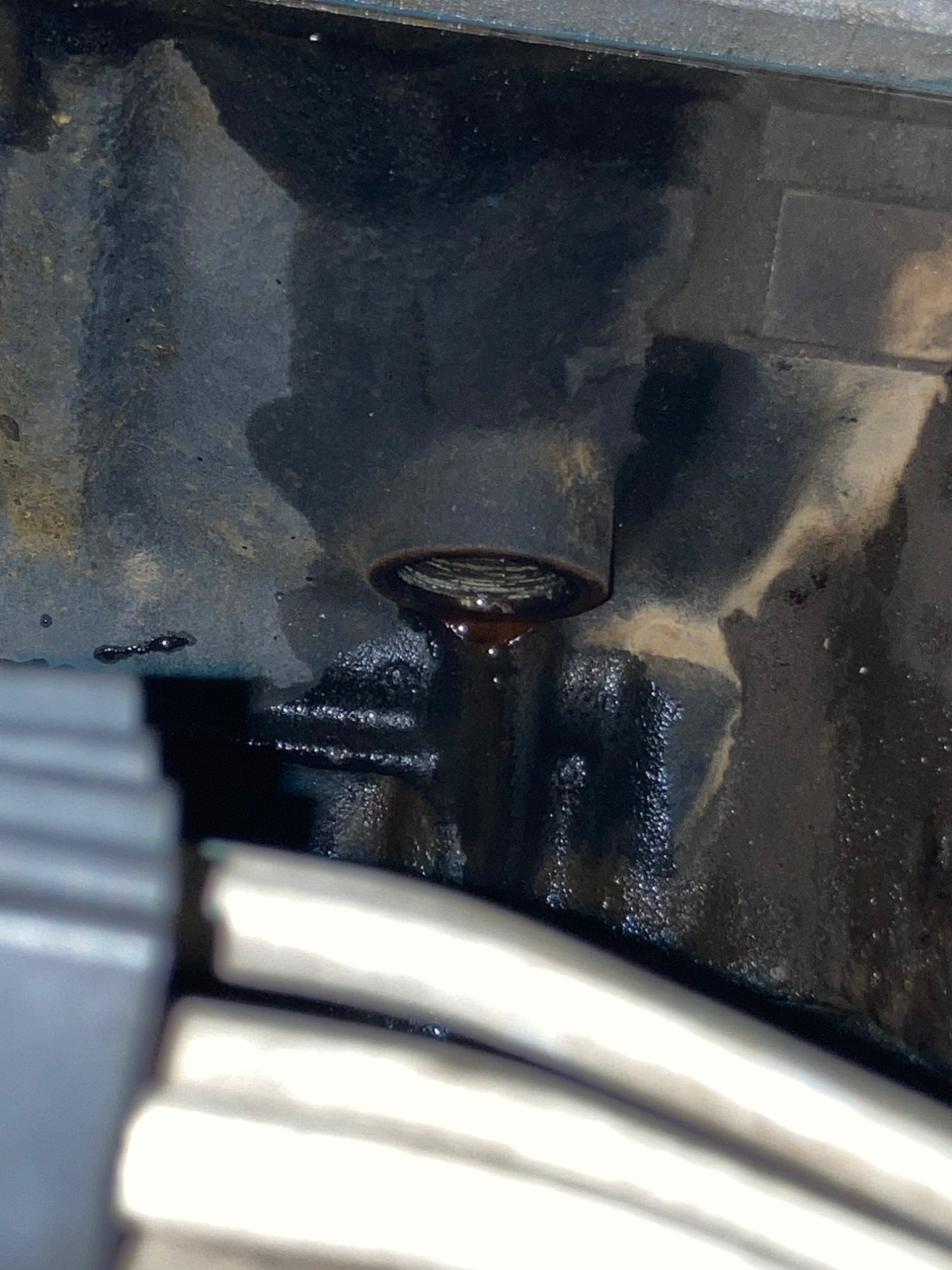

No big updates.  I received the replacement head today so I went ahead and finished pulling the old one.  I did not see any thing that looked like a coolant run on top of or under the head gasket.  I did drain the leg side of the block before I started; that was a help, but it opens up a channel for leaks.  If anyone one wants to see any pics of the job, please let me know.  I’m by posts pic of the block plug removed.
