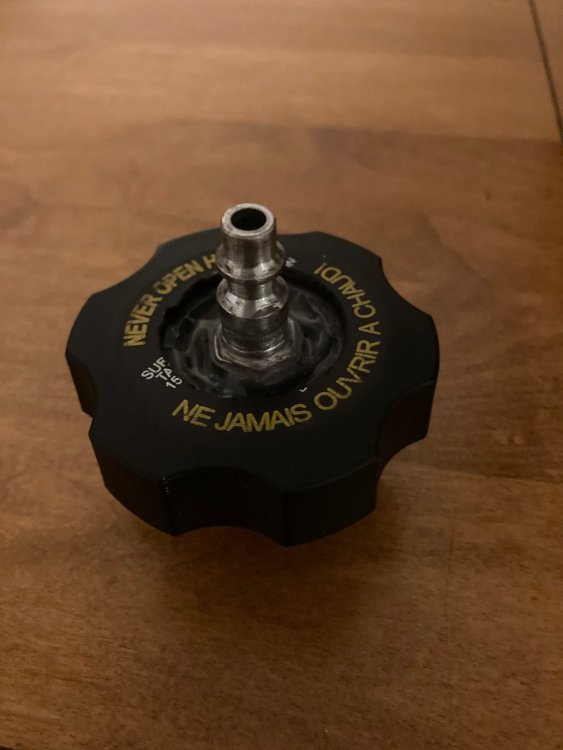

The pic shows the cap I made for pressurizing the system.  I took a coolant reservoir cap, popped off the top, took out the diaphragm, drilled a hole through the bottom, set in the air fitting with JB weld.  I then leveled the epoxy, drilled a hole through the top to clear the fitting and snapped it back together.  Kits like this can be rented, but I want to use my shop air regulated to around 12 psi and listen for leaks.  I’ll let everyone know how it goes.
You might want to bypass the heater core before you pressurize the system. They have flow restrictors and other things to protect them, because they are very fragile.
Some people become suicidal when they realize that the heater has failed.....

Thanks for the heads-up.  I hope I didn’t just learn an expensive lesson!
I pressurized with as close to 12 psi as I could get.  I heard nor saw no leaks.  The system held the pressure with the air cut off.
