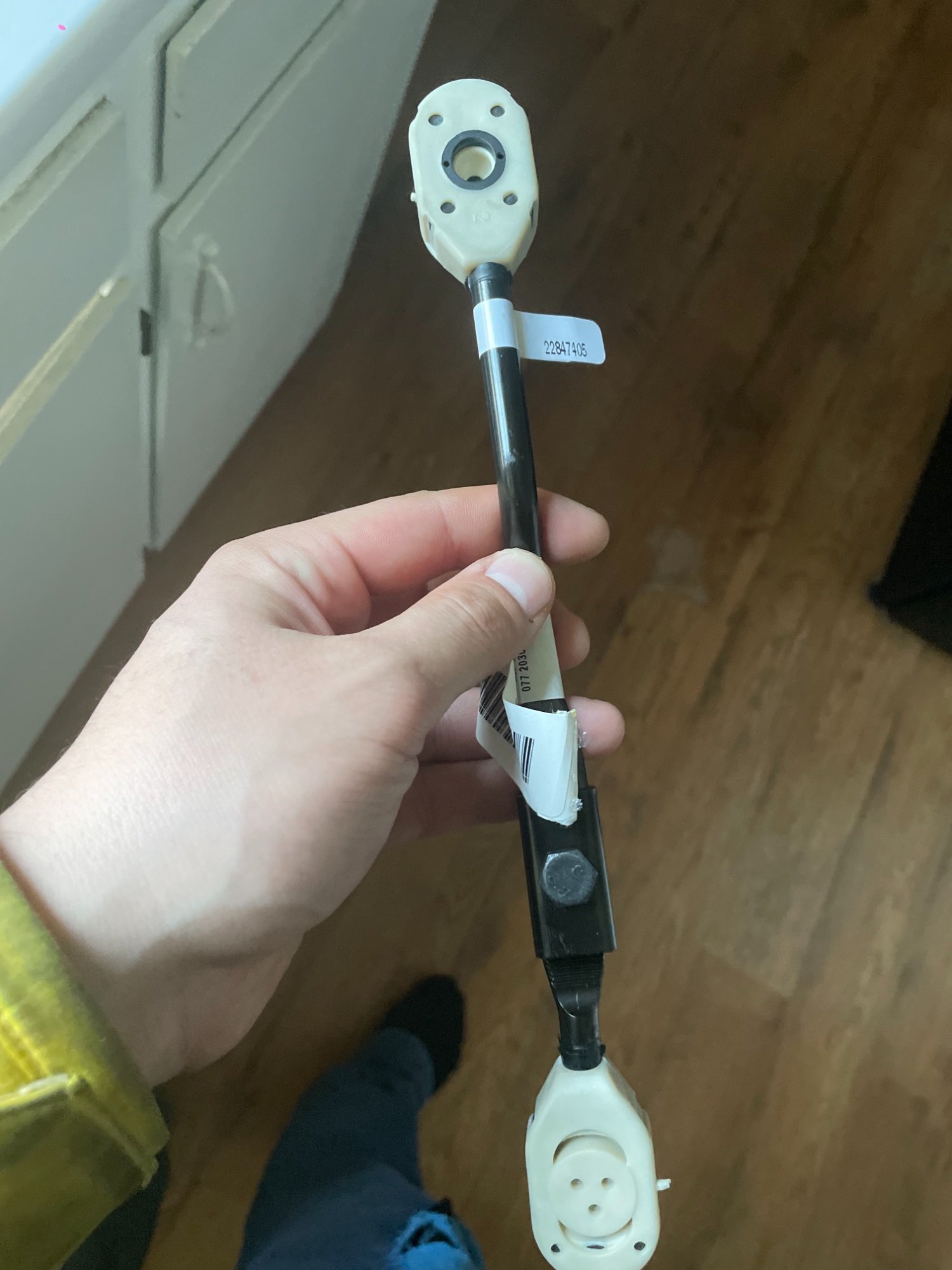

I have the 4 on the floor. The shift linkage coming back from the lever in the cab to the t case is junk.
it uses like a ball and socket. It’s almost apart.
Any aftermarket replacements? I seen nothing. Can get a used linkage off eBay but what’s the point. Should almost weld a steel rod from the linkage to the other side.
2016 1500 custom

Just get a new rod.  Its all of $40.  P/N 22847405 for the 5.3, the V6 uses 22753342.

reguardless I seen teraflex makes some stuff for the Jeep. And I seen some other kinds of bushings and some other things. I’m going to see if I can rig something up that doesn’t rely on plastic to support it. Who ever designed that should be shot.

Just get a new rod.  Don't over complicate it.
I could but I like doing it once. My truck has 55k on it. The linkage shouldn’t be warn.
From hole to hole it’s 9 6/8 or 25mm. I’m curious if you can take the stud out of the levers bracket? That would make this a breeze. I have have to order a bracket and see if I can knock it out. Getting to cold to tinker outside. In the mean time I should just order the factory part. It’ll work for another 40k lol.
