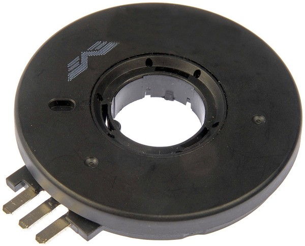

I would guess that the encoder motor is bad. They have a bunch of electrical connections inside of them that can go bad.
The round black ring have multiple electrical probes that slide on a disk.
As the disk turns, it redirects power though the different probes, and that tells the computer what position the encoder motor is in.
parts-jpg.30484
