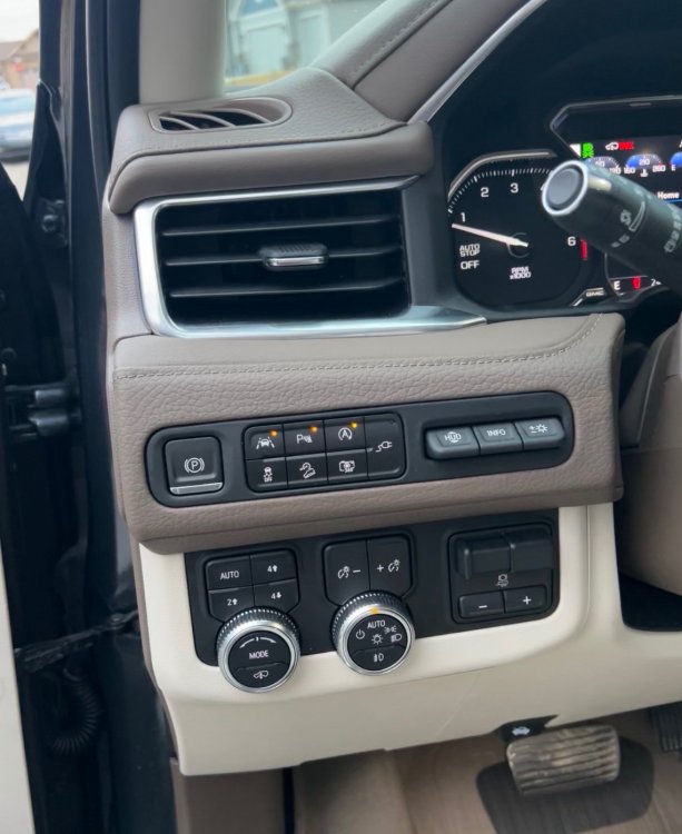

Anyways, update on my question.  IT IS PLUG AND PLAY for my 2021 Yukon XL Denali (build date May 2021).
Several people were saying it was not possible and just to trade up to a 2022 model, but I didn't want to lose any features I currently have. This was by far the best $70 I have spent on this vehicle.

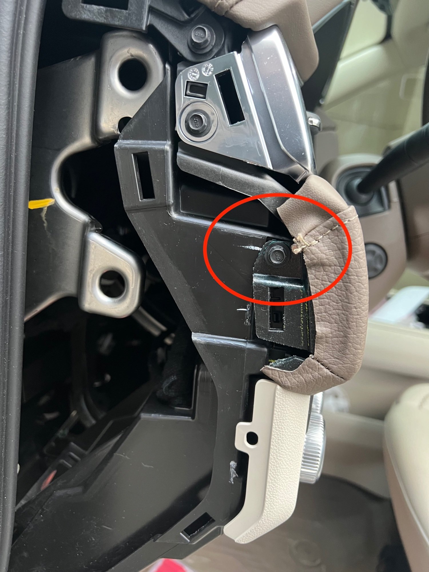

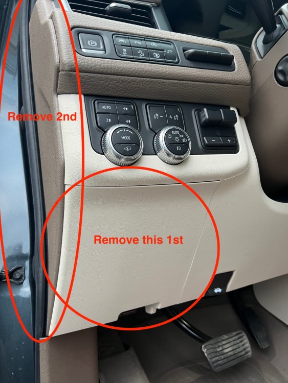

  1. Popped off the 2 panels: Do the bottom left of the kick panel first, then do the side piece.
  2. remove 7 mm screw that holds the trim piece with the switch.

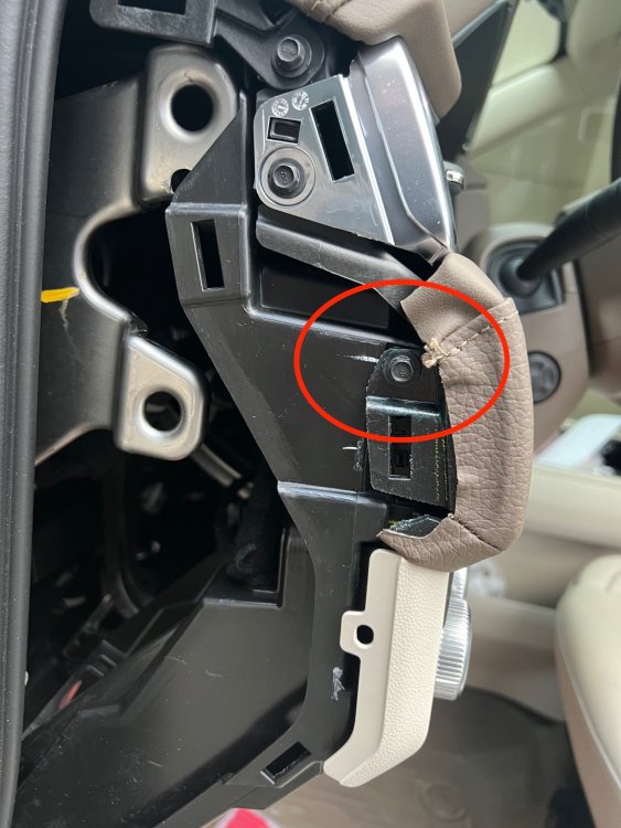

  3. pull straight out on the trim piece with the switch (4 retainer clips, see picture).
  4. remove clip but first using small flat head to slide red locking piece out (to the right in the picture) and then flip green piece down and it will release the harness.
  5. Remove switch from trim piece with small flathead to release clip at each corner.
  6. Install new switch and then put everything back!

Installed my switch panel today, everything works as advertised. It’s nice not having to navigate the touch screen to get the 360 cameras up. Thanks peterlawl84 for sharing the information to make the swap possible.
