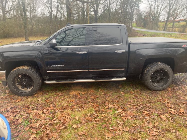

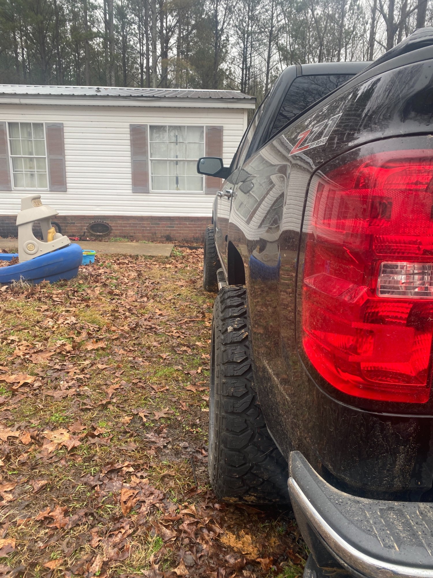

I have a 2015 Silverado ltz. It came stock with 22s. I traded for 20x9 rims with 33x12.50 tires. It has a offset just not sure how much. What can I do to keep it from rubbing. Not sure if I have a leveling kit or not. Thanks
You'll need to stick your face under the truck to see if there is a leveling kit then. Either it will be a block under the strut to lift it up, a spacer block on top of the strut mount or it will have aftermarket front struts from a brand that does leveling kits. Meaning it won't be an AC Delco branded strut under there.
