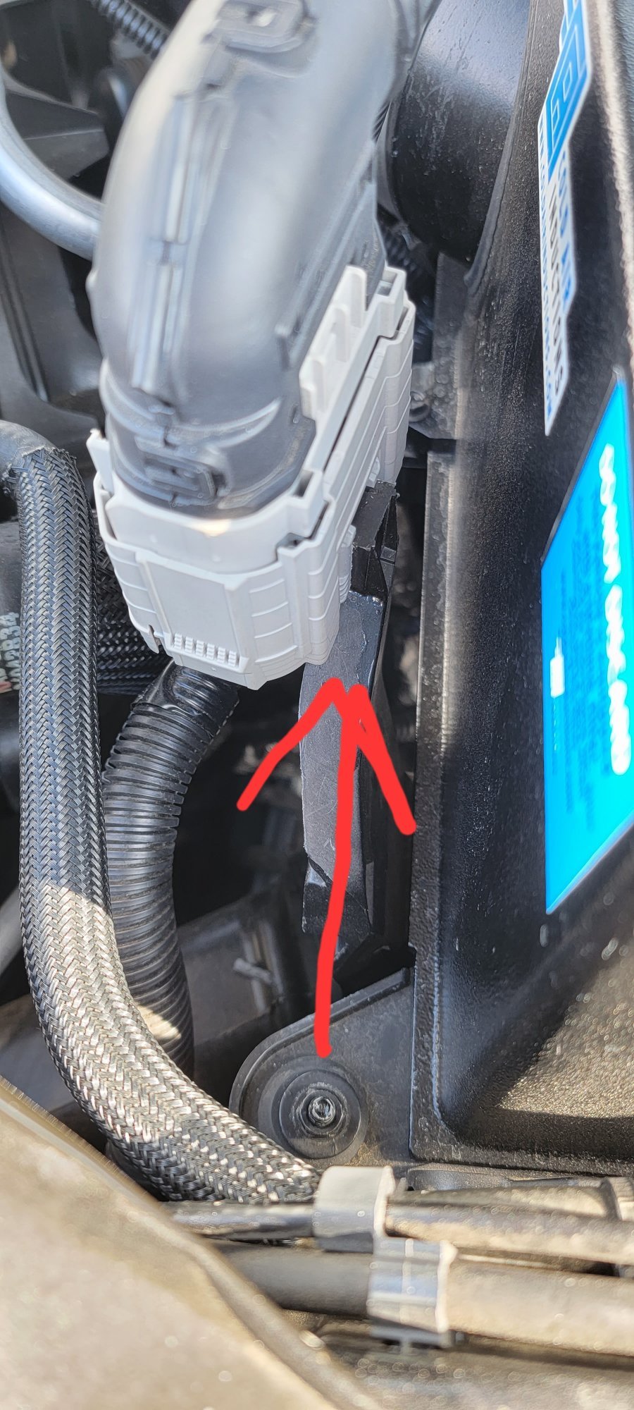

Hey guys does anyone know the part number or how to get a new bracket that the PCM connector connects to? It's for a 2021 trailboss 5.3l. Thanks
Edited by McM21
Are you referring to the black rails that plug sits on?  If so, and iirc, those are part of the air box.
Edited by Transient
Yes the plug slide down on those tabs. I looked at a oem air box and it didn't have that bracket attached. So I'm pretty lost lol
I can't even do that. The tabs are broken. If I can't replace it I might make one out of metal
I just took a look at mine.  Confirmed it is part of the air filter box.  It's the lower portion, and both tabs on mine are broken.  I have the GM Performance CAI.  If you take a look at some of the aftermarket CAI you'll see they use a metal bracket/clip for that plug.
Edited by Transient
My Pulsar kit came with a metal bracket that goes to the bolt for the second plug. maybe you could contact them and see if they offer it as a stand alone part.
I just contacted them yesterday. They are sending a bracket out. So I'll rig something up. Thanks
Take a soldering iron and melt the two plastic pieces back together.  I've done it on multiple occasions in the past and it works well.  I've sealed many cracks in plastic dirtbike fuel tanks that way.
