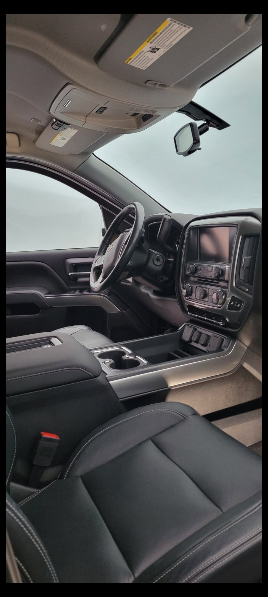

The part # i used was
84502917
It's black with the charging armrest.
Get all your harnesses here.
This guy is a 10 out 10.
You need the main harness and two USB cables.
www.harnessdr.com
Make sure you get the right trim on the upper trim panel .
Mine is called synthesis.
Most are LTs like this

You dont need your vin to order it.
  They are all the same.
These fit all Silverado/Sierra
2014-2018 and 2019 LD
1500,2500,3500 dbl cab and crew cabs .
Here's the cheapest I found today....
