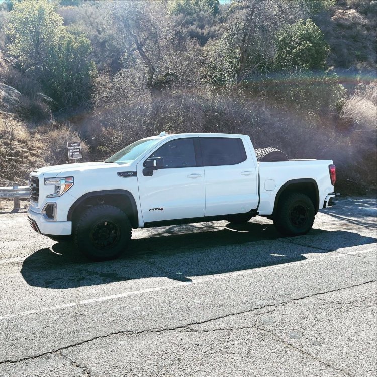

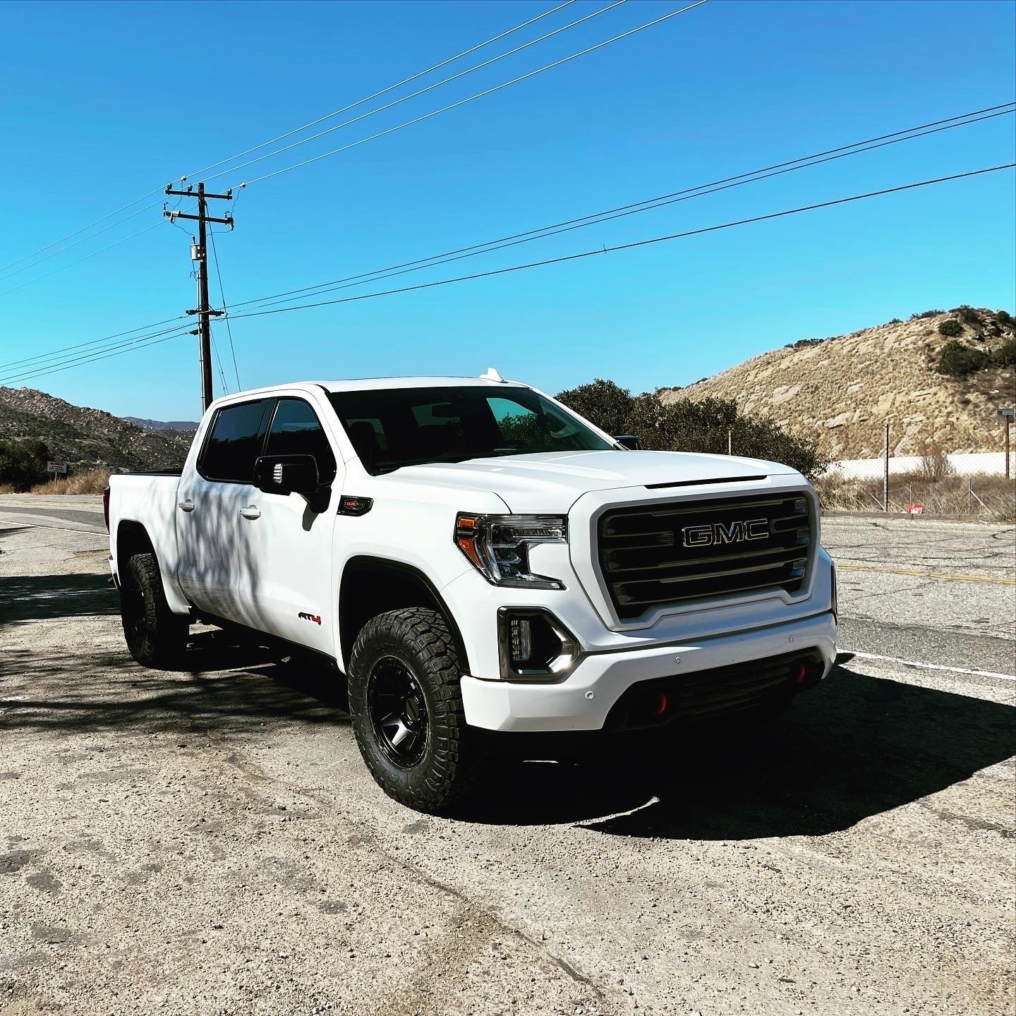

I'm running a 305/70/17 Nitto Ridge Grappler. Had to trim a fair bit to get this tire to fit with a 0 offset wheel. That included getting a mudflap delete and trimming the plastic. Also deleted the crash bar behind the mudflap but I could probably put that back on. You may get lucky if you keep the stock wheel as it will be pushed in closer to the engine bay.
I live in Southern California so I can't comment on how these tire perform in the rain or snow. They are quieter and ride better than the stock Wranglers.
Noticed a slight decline in MPG but not bad.
