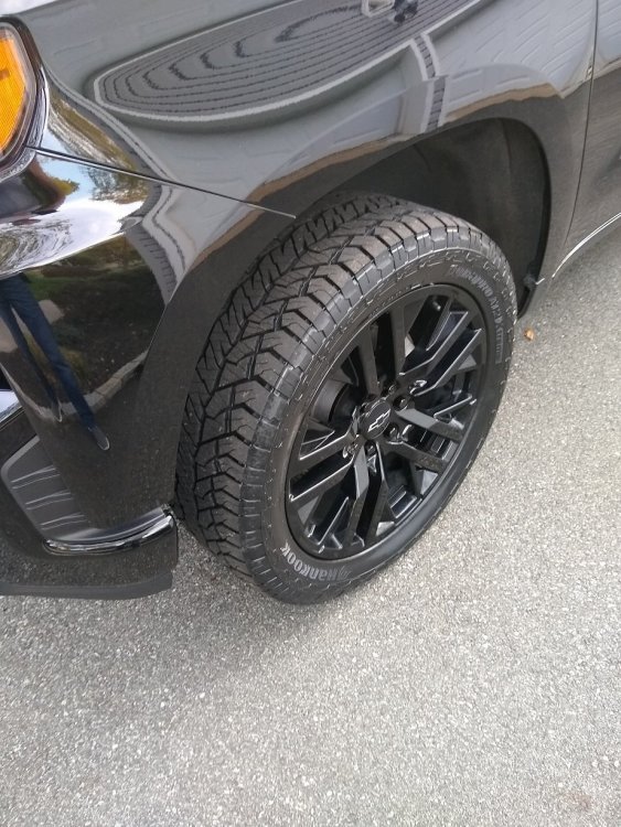

I went with 305/45R22 Hankook DynaPro AT2 Extremes (RF12's). Couldn't be happier with this choice.
