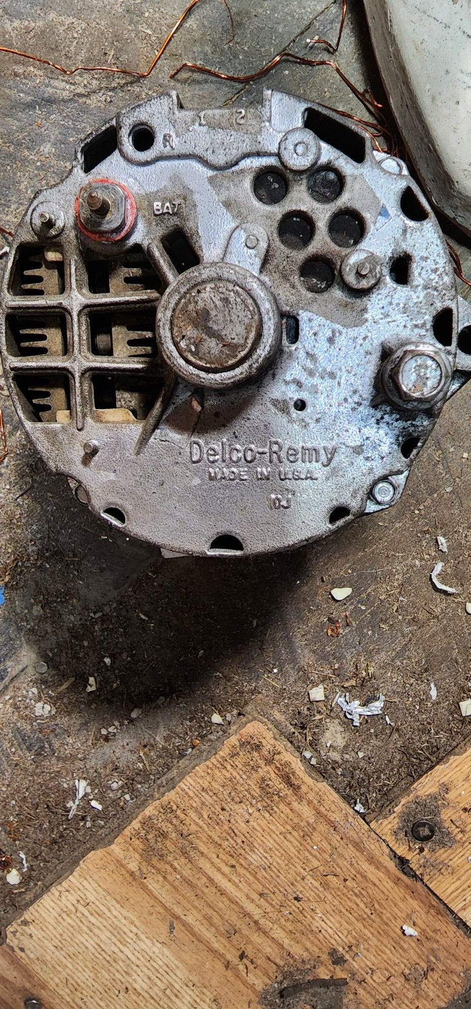

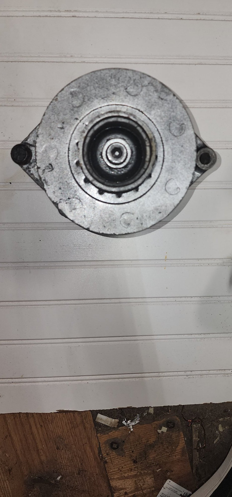

I just removed the alternator from '88 5.7 350. I'm trying to identify exactly what I'm gonna fix or replace. I've done research ad nauseum and discovered and learned plenty. I've yet to learn the specs of this alternator. Its the 10J i cant find anything abo16783302435687372659278720805832.thumb.jpg.f2026450ec510b37a68ad30c5928d322.jpgu16783301632918855961626322592124.thumb.jpg.853ea80ed4d0608a9f1a8a681c58543b.jpg
Welcome to the Forum! The part # and amperage are usually stamped on the boss where the long bolt goes through. Why you want to mess with it? just go buy a rebuilt or go to the boneyard and get a used 1
4 hours ago, CamGTP said:
I had to look it up as a 1987 truck to find an alternator that style.
Look to be exactly like this one. It's a 2 pin design with 94 amps. Swap the pulley and away you go.
https://www.rockauto.com/en/moreinfo.php?pk=12526877&cc=1059825&pt=2412&jsn=812
Thanks CamGTP for the feedback! That's exactly the info I'd been searching for and in some cases those things that aren't easy to find are worth the extra effort. I planned on upgrading by bumping up the amps with say a  220A, but I wouldnt know if I was upgrading, staying the same, or downgrading until I knew what I had to base the decision. Thanks again for your time and input.

Thanks for explaining your circumstances. Those alternators were always very reliable compared to the early cs alternators that had bearing issues. They are easy to work on and worn brushes were the most common failure, they also fit many GM vehicles just by changing the clock position, a good 1 to keep on the shelf if you work on older stuff, Also it may self excite which makes it an easy adaptation to somewhere it wasn't intended to be just by running a wire to the battery. Lots of very experienced people here so come on back with any questions or advice to ask or give
