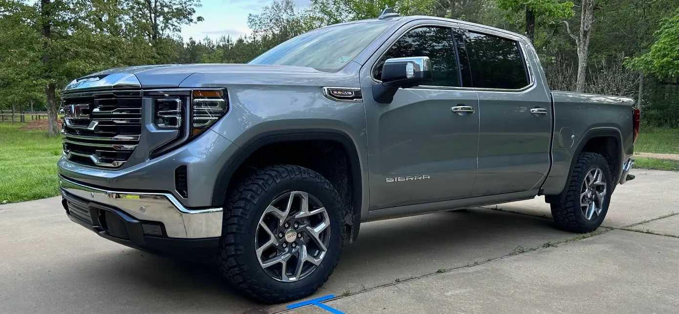

Thanks for the response!  Yeah, I bought them and installed them about 3 weeks ago.  Set the front to +1.5” and I still have just enough rake so the back end doesn’t droop when a trailer is connected.  I’ve been really happy with them and the ride is much better as well.

Sharp truck! What color is that?
Thanks for the compliment.  It’s the Sterling Metallic they added for the 2023 model year.  Replaced the Quicksilver Metallic from 2022.  Sterling is a little darker than the Quicksilver was.
Edited by msubullyfan
What size tire is that?
It’s stock size (275/60r20), but the specs for that tire (Cooper Rugged Trek) actually show almost a half inch bigger diameter (33.5”) than the stock Goodyear Wrangler TrailRunner A/T.
