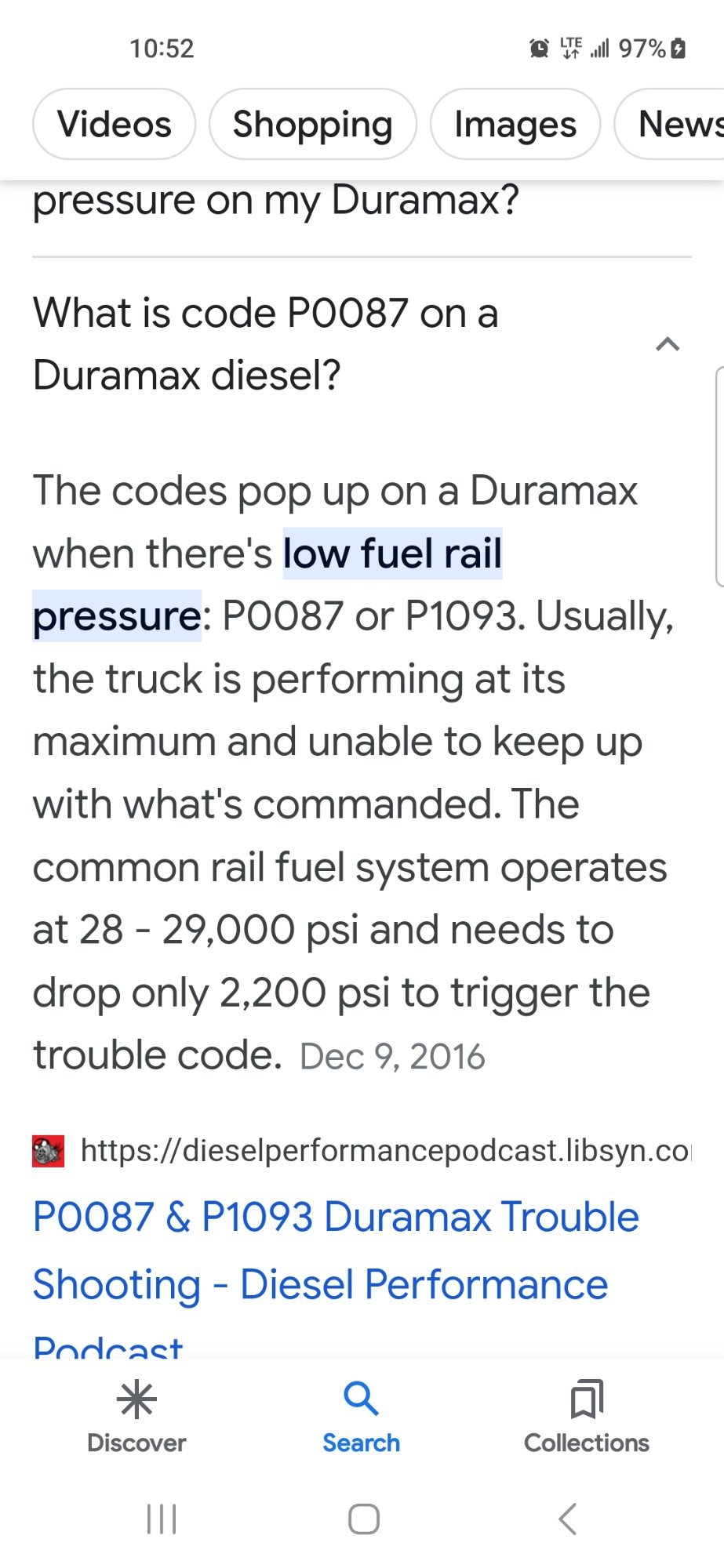

Not sure what your asking? Your question is veige. It was a common error code for loss of pressure in Fuel rail line. Attached is the skinny on it.
P0087 is not a good sign typically.  P0087 - Fuel Rail Pressure (FRP) Too Low.
