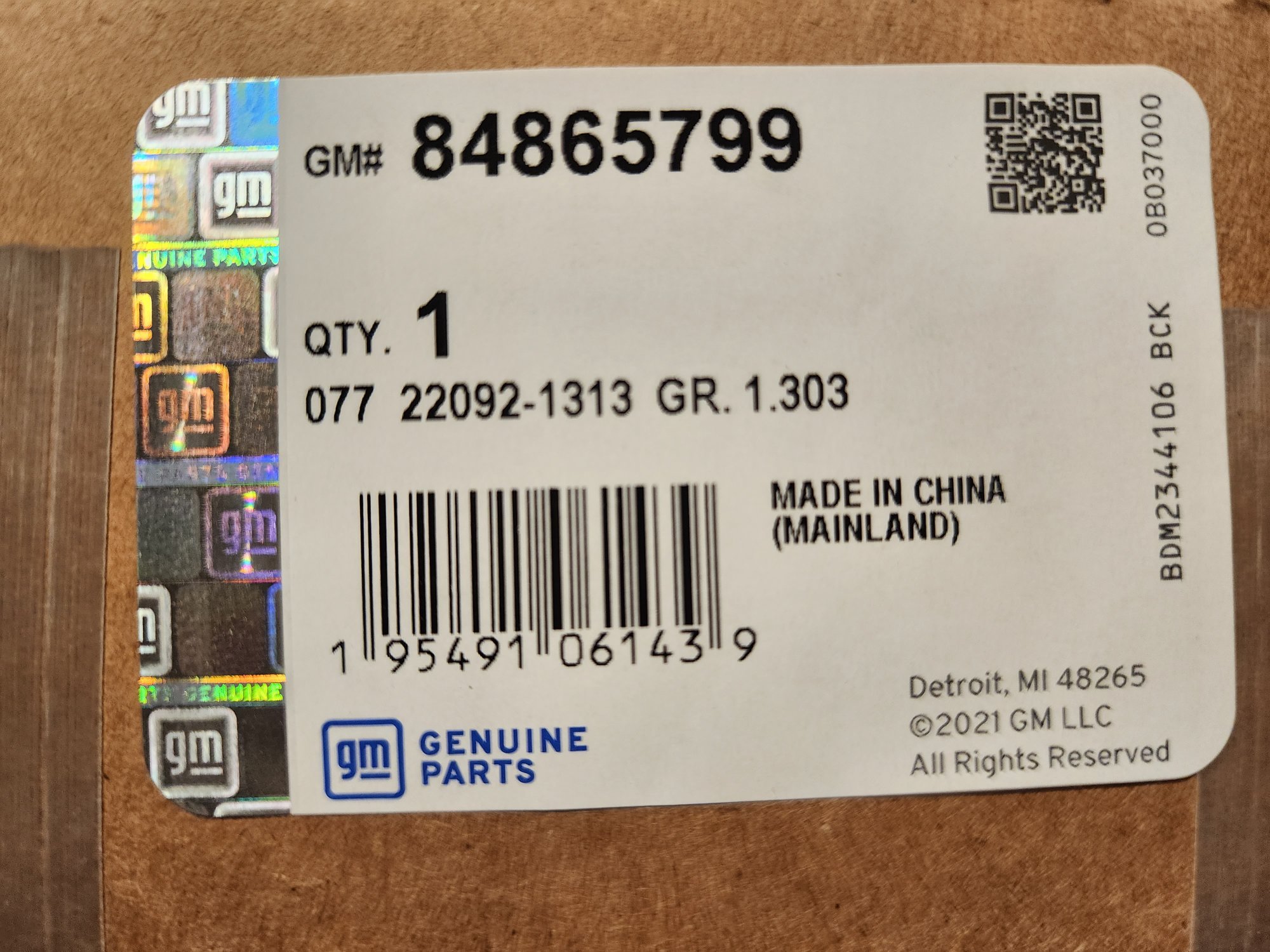

Hello, I think that the Flowtie emblem part number is: 84865799
https://www.gmpartsdirect.com/oem-parts/gm-emblem-84865799?c=az0x
Double check with the seller before you buy.
That is the correct flowtie. It comes with the chrome and red piece. It is slightly different in dimensions compared to the other Silverado trims. Didn't match up to my 23 High Country bowtie. I'll post pics when I get a chance
Are we absolutely sure of this?  Because I looked at that part number and at some of the other parts outlets, the description is "ZR2 Emblem, "ZR2" text"...which sounds to me like the ZR2 badge that mounts on the left side of the front grille.
Here you go. I ordered another one for my ZR2. It's the front Bowtie
Ok then i'll get that ordered.  Hopefully i'll have my lights soon so I can get started on the bumper project.  I'll post up when I am able to get to it.
