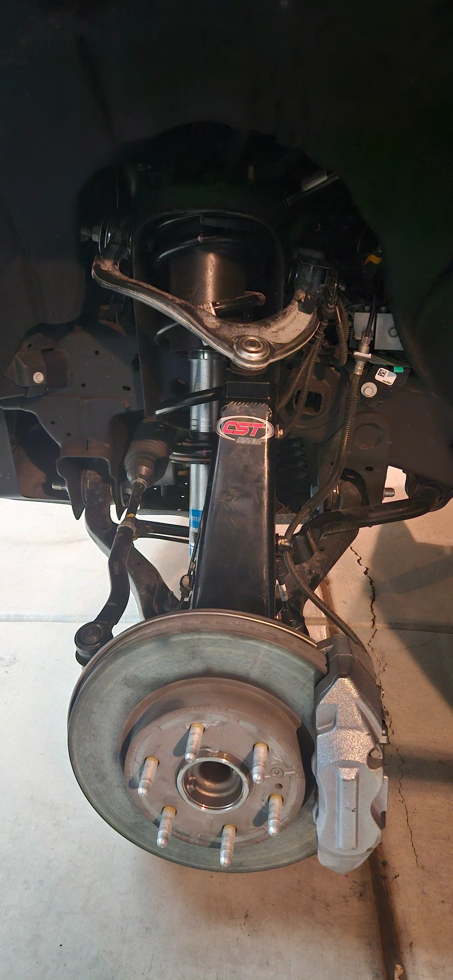

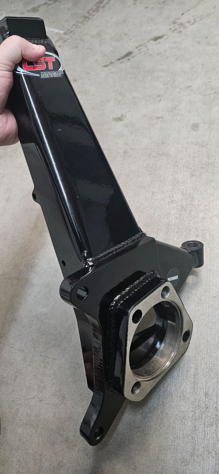

-CST Fabricated 3" lift spindles
-Bilstein 5100s set to .5" lift, maybe 1"
-Bilstein 5100s rear 0-1"
-1" lift block maybe. See how it looks w/o
My truck sits 2" nose down stock, and eventually will go full coilovers and an upper arm, but with only really .5" of lift being put on the upper geometry those can all wait a bit.

Yup, i already have the lift spindles, and front/rear Bilstein 5100s in the garage. Then down the line a bit ill change out the upper arm for Icon or Mazzula and some coilovers.
Im using the spindle to get the lift without having to preload any coil if any at all. This should keep the best possible ride quality with added track width and ground clearance. The lift spindle just drops the hub mounting location down and doesnt change any of the upper/lower arm geometry. The .5" or so ill have on the front Bilsteins will need an alignment though.

Adding pics of both spindles and the LEDs i went with.

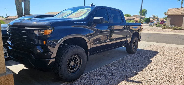

Wheels/tires will be in next week.
17x8.5 KMC Canyons in black
315/70/17 Nitto Terra Grappler G2's
Then can finally get everything on
Looks good, that's a lot of sidewall on those 34"+ tires, I like it!
Edited by Gangly

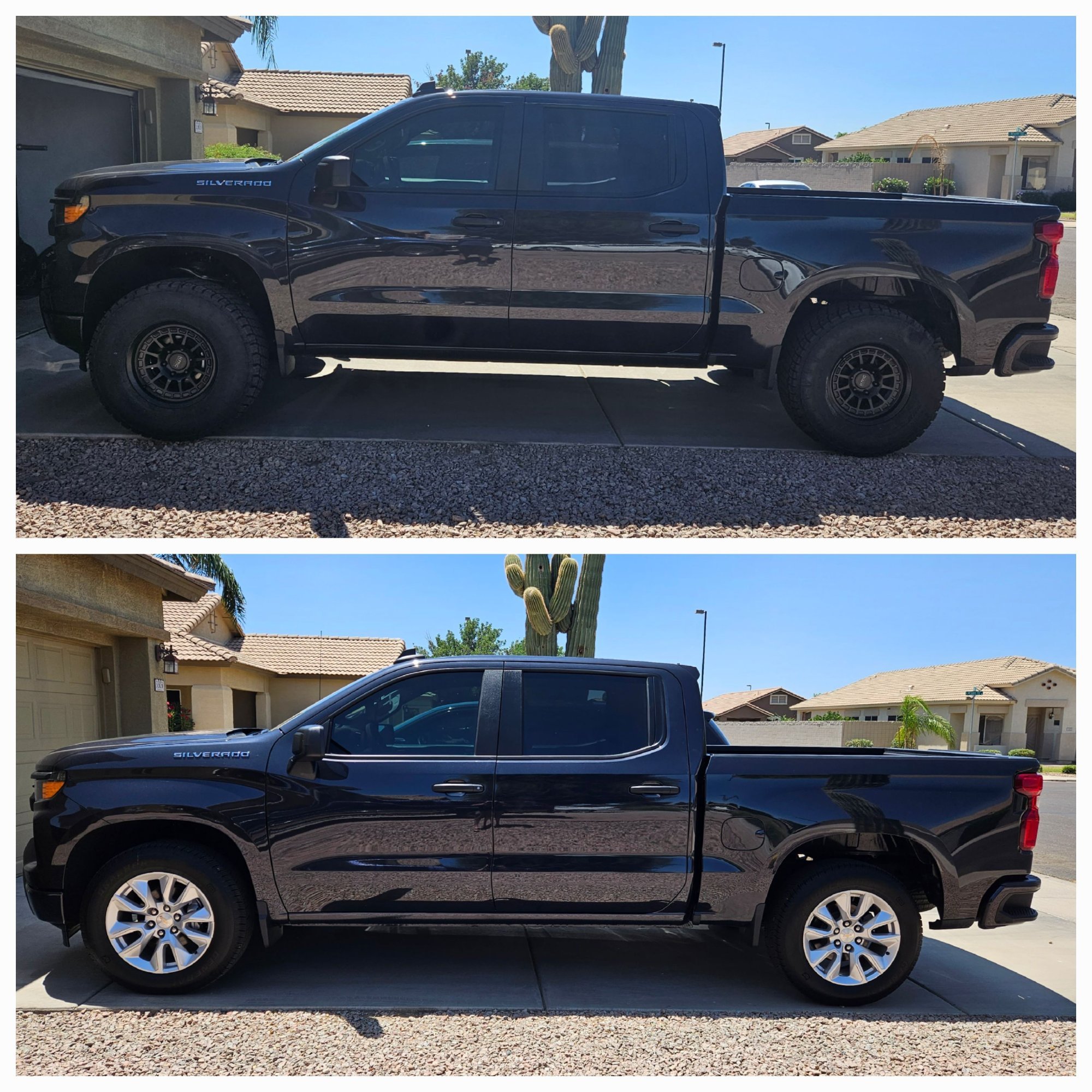

Finished it up last night. Need to swap the silver bagdes out still and the intake/charge pipes. Added a black tip on the exhaust as well.
With 0 preload on the 5100s, it rides great and upper is in same position as stock at ride height.
Before
After

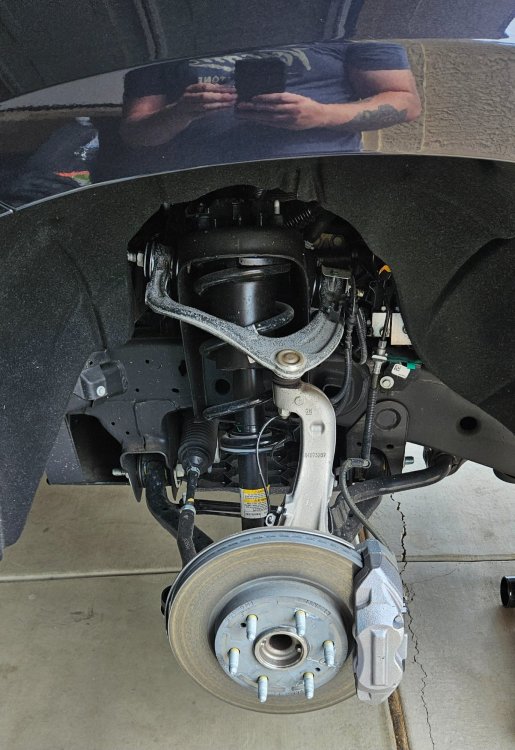

Also, for anyone looking to do the fronts on their own, but scared about losing 3 fingers....this is the compressor I used. It felt much more stable and stronger than the typical ones you can rent from Autozone, and the bridge helped keep things even side to side. At no point did it feel like it was gonna pop or even bow any. I also just used some grease/lube on the threads to keep it smooth. Also, have a good pair of vice grips to hold the end of the shock shaft or a pass through socket.
https://www.amazon.com/BILITOOLS-2-Piece-Compressor-Macpherson-Load-2645LB/dp/B09PYR6NVF?th=1
On the front it started at 22" hub to fender lip. Its at 25" now, so the #1 notch on the shock with a 2.7L will be true stock setting as the spindle is giving the 3" of lift. I also used paint pens to mark centers on the spring seat and cap to keep all that aligned for re-install on the 5100's, then again for all the bolts to do an easy check for anything coming loose.
Getting an alignment check today. Drives straight and true, but steering wheel is slightly left
