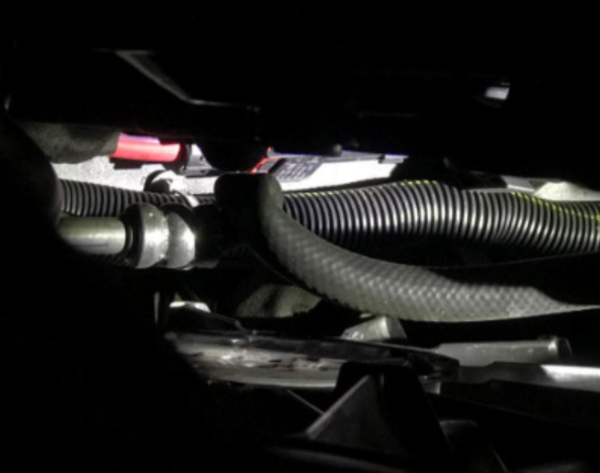

Well it doesnt work. I have no idea how to attach something to a post . The bulletin number you should have them check is 22-NA-182, document ID number 6147440. It pertains to the problem that you are having. Hope this helps.257 is much too high.
Can one of you guys find that detailed image the document mentions and post it here please? It will also give you something specific to look for on your truck Arthur.
The picture provided in the TSB isn't very good:
But I'm going to have a better look at it sometime this weekend and see if I notice anything.
Follow the path of the cooler lines and make sure they are not restricted or kinked in any way.Don't keep driving it with the temps that high. Fluid will degrade and loose all the additives  and lubrication properties put in it to protect the transmission. Just check it yourself and stop dealing with that crappy dealer.
I'll do that this weekend, and see if I can find anything. I appreciate it a lot.
You're right, it's hard to tell. The most obvious possibility is what I circled. But I'm really not sure. Please let us know what you find. and where exactly it is if you do find it.
Edited by TrueBlue
I'm actually looking at the alldata description for removal/replacement of the cooling lines and they look to be all metal lines on my application. I'll follow up with what I find.
Not sure where/what that hose is from just that picture, but that kink is a problem no matter WHAT line it is for. It's killing flow!
