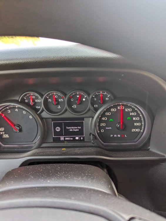

As an update to this whole ordeal, I took the camper out again last weekend and the transmission overheated again. This time went to 132C (270F) before setting off the alarm for "Hot transmission - idle engine".
It went back to the dealership, who took it for a test drive, was unable to replicate the issue, checked for twisted lines (none found), updated the TCM, and noticed the transmission was down 1L of fluid and gave it back to me saying it's good to go.
While I doubt this is fixed, I will take my trailer for a drive this weekend, but fully expect it to overheat again.  1L on a 11-12liter capacity 10L80 would not cause the transmission to go nuclear this quickly. I'm guessing there's either a blockage, or the bypass valve internally is faulty.
As far as the GM post above, they emailed me back and supposedly are acting as a mediator between the dealership and myself. We'll see if it goes anywhere, but as of yet I haven't heard from anyone.

Just for a further update for anyone else that has this issue and needs to deal with their dealership.
The transmission overheated again yesterday towing my utility trailer on the highway. As expected, the 1 litre of fluid and a TCM update did nothing to solve my issue, so back to the dealership I go. Woohoo (sarcasm).
And to boot, I'm pretty sure the truck is clunking in the rear, probably the famous loose U bolts on the leaf springs. I'll get them to look at that too. Whenever I get this resolved, I'll be sure to post my findings here so that hopefully it saves someone else some time rather than wasting time with these dealerships. It's ridiculous how bad the service can be at times.
Update: dealer looked at it today, said they couldn't find anything wrong (AGAIN).  Asked when I was going to pick it up, I told them I don't want to take it back until they've found a solution.
I have no interest in lying to these guys, I'm not sure why they're so hesitant to keep it and try to replicate the issue rather than spending 15 minutes on it, and shrugging their shoulders. I just want my truck to be reliable, it's got like 2000 miles on it lol

UPDATE:
Today after a call to the service advisor, and then a lengthy email to the service manager I was told they are ordering "parts for the transmission". They're not sure if it's going to fix it, and they didn't want to throw parts at it with the hope of it getting fixed (which I appreciate) but the plan of not doing anything wasn't going to sit well with me.
That being said, I'm not sure what specifically they ordered, so I'll be checking into that tomorrow. Whenever I have the new "parts" installed I'll clarify what they are, and if it fixed my issue.
Edit 2: After some back and fourth with the dealer, they claim to have ordered the valve body. We'll see if this is the fix. Will update.
