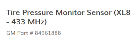

Accessories shows they do have the same description and frequency
but they are physically different and of courses also different part numbers.
2021
2023
Can anyone shed any light on using the old sensors on a 1500 with the new TPMS system?
38 minutes ago, bwoodsmn said:
No, they are different and are not cross compatible.
bwoodsmn is right the sensors from the 2021 will need to replaced with 2023 sensors to work on your new truck. When I got my new Trail Boss I had to install new sensors in the 20" wheels from my 2021 T.B.
Yea, you need the new ones.  They are totally different sensors.
The old ones may or may not synchronize during a manual relearn (with a relearn tool) but will immediately drop out once you start driving.
The old sensors are considered a "manual" learn sensor.  You need to trigger them to the truck in order to sync them to the truck.
The new sensors so 2022 refresh and newer 1500 and 2024 HD are an auto learn sensor.  You rotate or install a new sensor, and the truck will automatically learn it to the truck and its position on the truck for rotates, etc.
Both operate on 433mHz frequency but have different operating protocol past that (GM Global B/GM VIP), so the auto learn 433mHz won't work on a 2019-2022 LTD, and a 2019-2022LTD sensor won't work on a refresh 2022 and newer 1/2 ton or 2024 HD.
