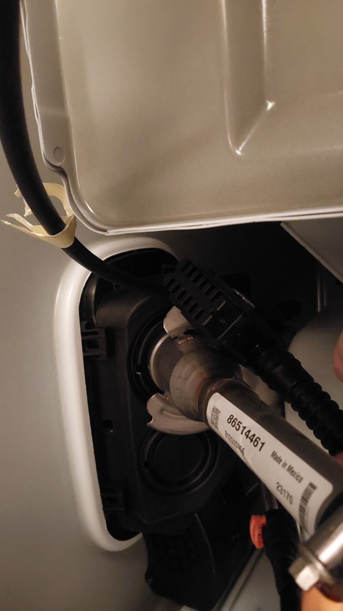

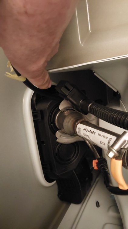

Would anyone happen to know what this plug is for, as it is attached/hanged , behind the capless fill. You have to look under the truck to see it. I am looking for the wires for conecting a 7 pin trailer/ camper wires. My lbz had them taped under the bed in this area, but not a plug end on it. My new truck is a 24 gmc 3500 dually, gas. I know I have them at the rear, but this area is best for me. Thanks

Its just a breather for the evap vent. Its not an electrical connector or cap of any kind. The 7-way blunt cut, if present is usually balled up in tape near the frame rail.
Thanks, I followed it back to something beside the gas tank. Evap canister I guess. I never would have thought it was a vent by looking at it.
