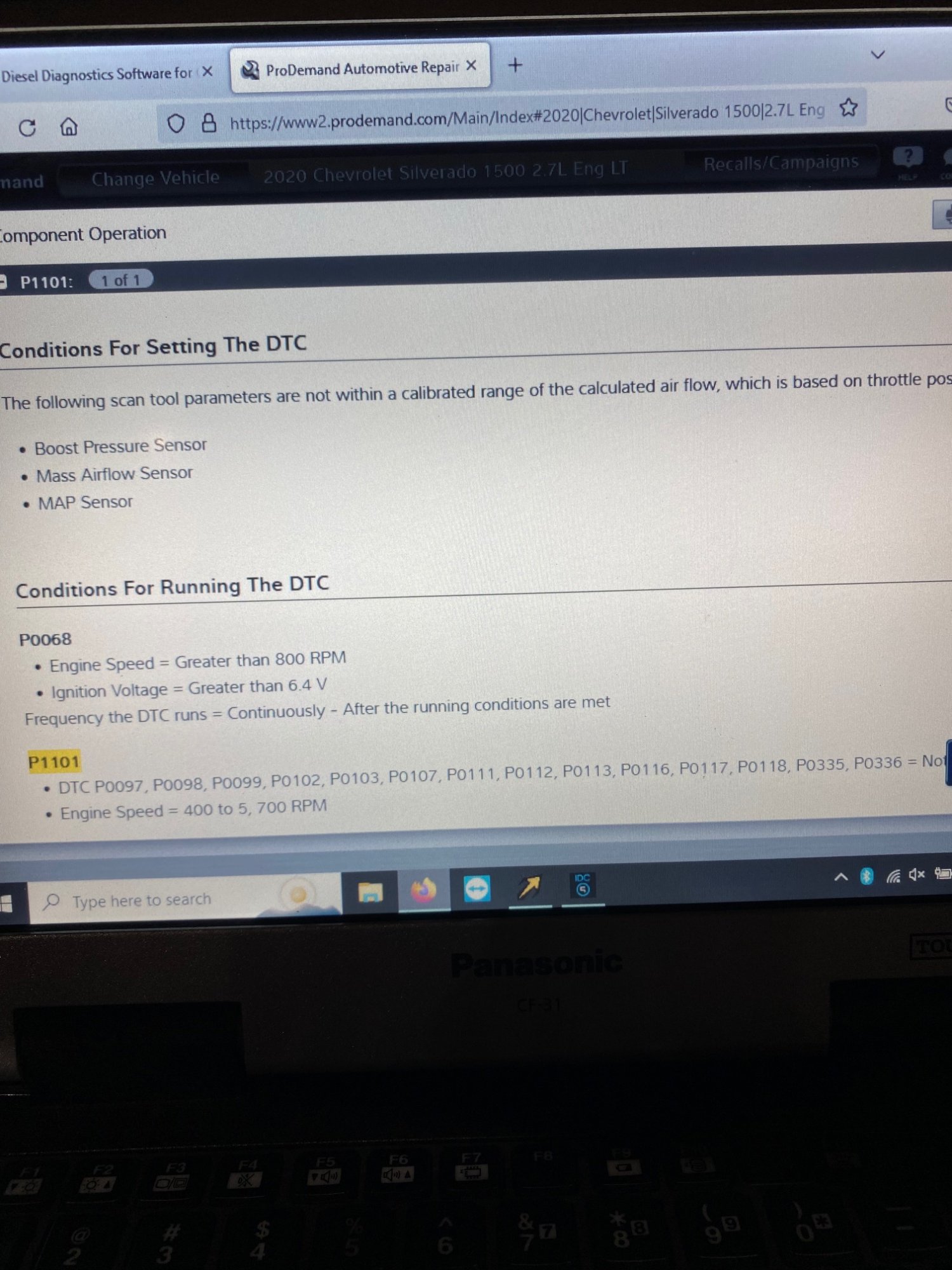

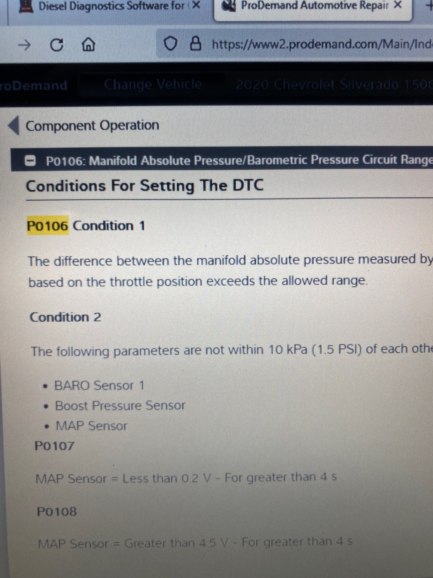

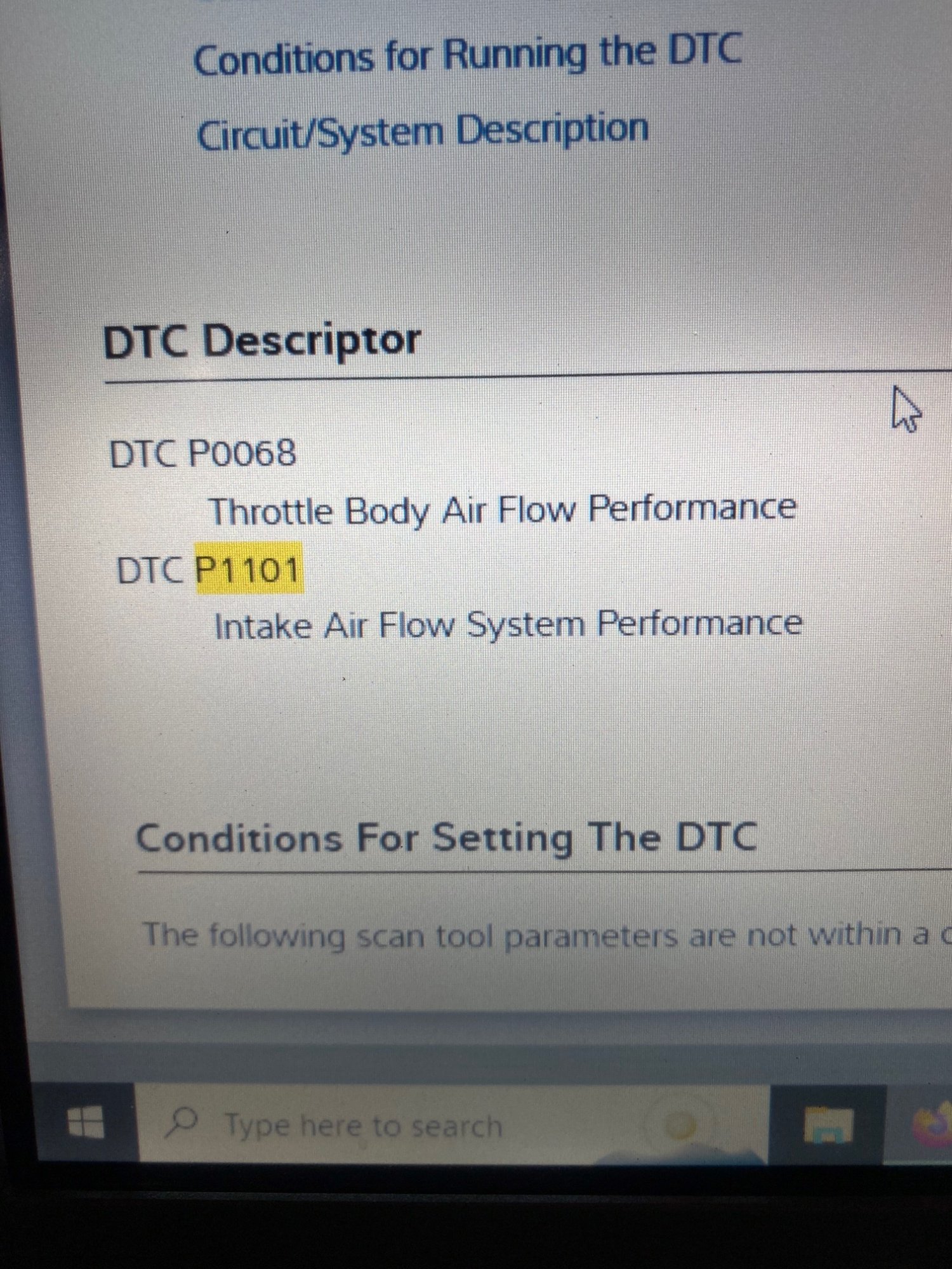

driving to work today and these codes came up on my 2020 silverado. engine is idling really rough and surging. freeze frame data doesn't really give a direction to go. any suggestions. truck has 70k miles
thanks guys give me a place to start. took the air intake off so i could get at the engine harnesses better and found another problem, my intake and turbo are covered in oil. starting to wonder about this engine
Following.  I'm on the fence about getting my kid a Colorado or a Tacoma.  He likes the Colorado, and I like the price.  My focus is on longevity.
problem solved, had son check and add oil, he forgot to put the fill cap back on. cleared codes back to normal running except for the new oil consumption problem. go to the 2.7 oil consumption post and see the pics i posted
