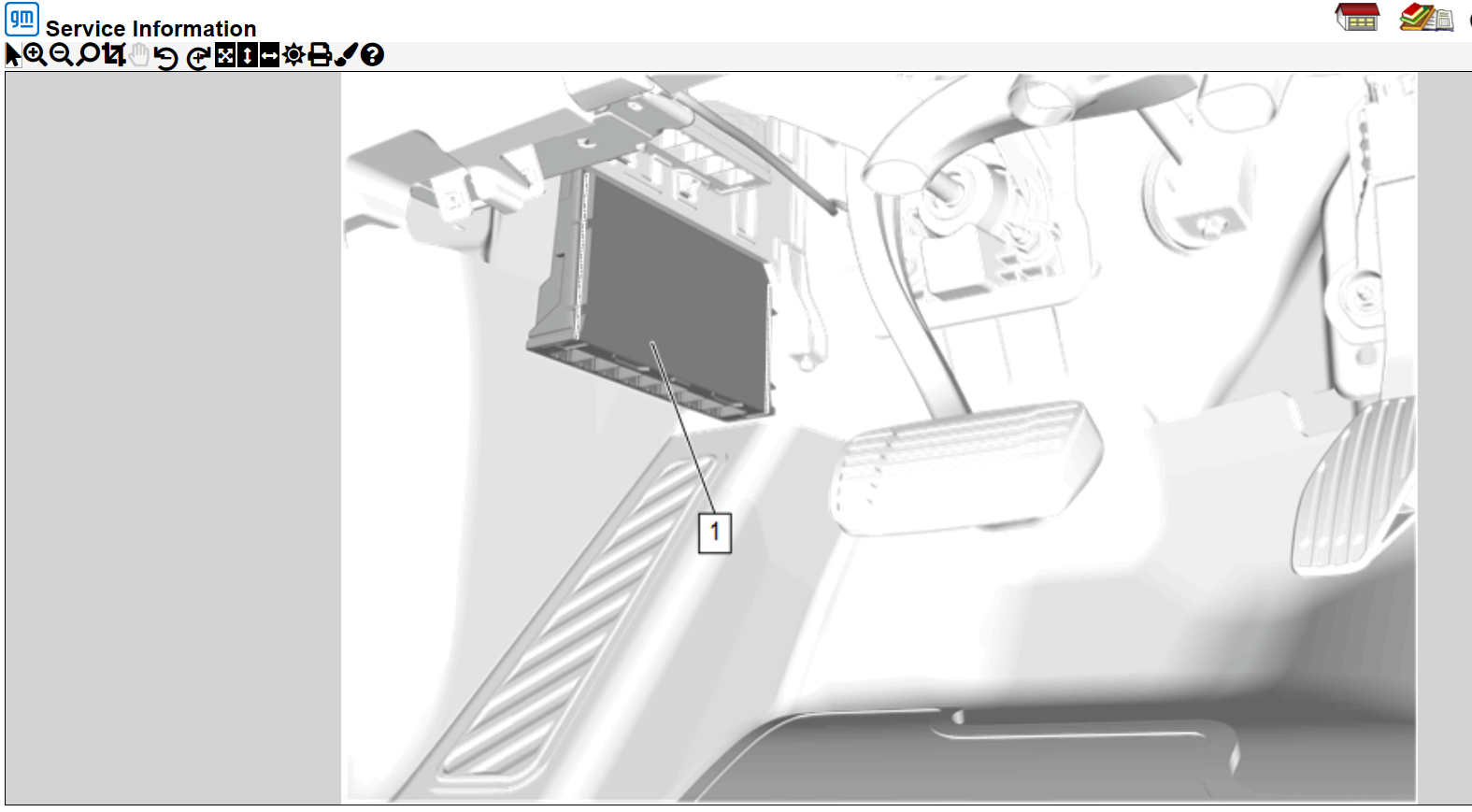

Hello there!  So I am working on installing these door sills using these instructions (because of course, on GM's own site, the instruction file failed to open) into my truck, and I am stuck on step 23, which is where you're connecting the power source to the BCM connector.  Namely, the connector itself appears to have cavity #1 already occupied.  The reference photos also don't really line up either - in the photo below step 25, I see two boxes with connectors but the closest box only has 5 - the one BEHIND it has 8...so am I pulling the wrong connector entirely?

Believe that other one is the lighting control module.
So, looking at my first photo, it's the connectors buried farther back in the photo with 7 connectors then?
Then I run into the issue where the connector does not look at all like the one in the instruction manual, here.  I'm mainly talking about the 4 larger openings on the bottom.  Also, it looks like the very top left port on THAT one is occupied, as well.

Final update: I figured it out.
Pretty damn furious, because it's GM's instructions that were bad.  The arrow for orientation of the truck in the diagram is literally backwards.
It was, indeed, the very back, upper box...and to make it worse, it was the connector on the OPPOSITE end of the box, closest to the firewall.  It's difficult to get to, putting it mildly, but once you get it out, the single power plug does indeed go right into the port shown in my picture above.
So, for anyone else searching for this endlessly, I'll save you a lot of time, I hope: IT'S THE BLACK ONE TOWARD THE FRONT.
