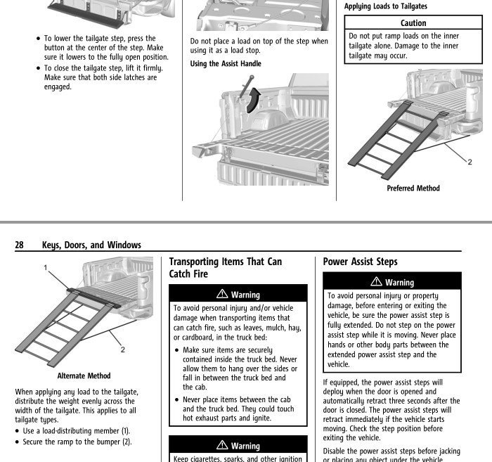

13 minutes ago, Crazy Canuck said:
Have not but i have been hesitant to use ramps at all with the multipro gate.  I think my Outlander weighs in at 800 lbs at least, those little hinges don't pass the smell test for me.
They show a strip of lumber to rest the ramp on. I have a tri-fold ramp for loading my sled. There isn't much to on the ramp to 'butt up against' the top of the tailgate to start. Add a piece of plywood to spread the load like they show in the manual, & you reduce that.
