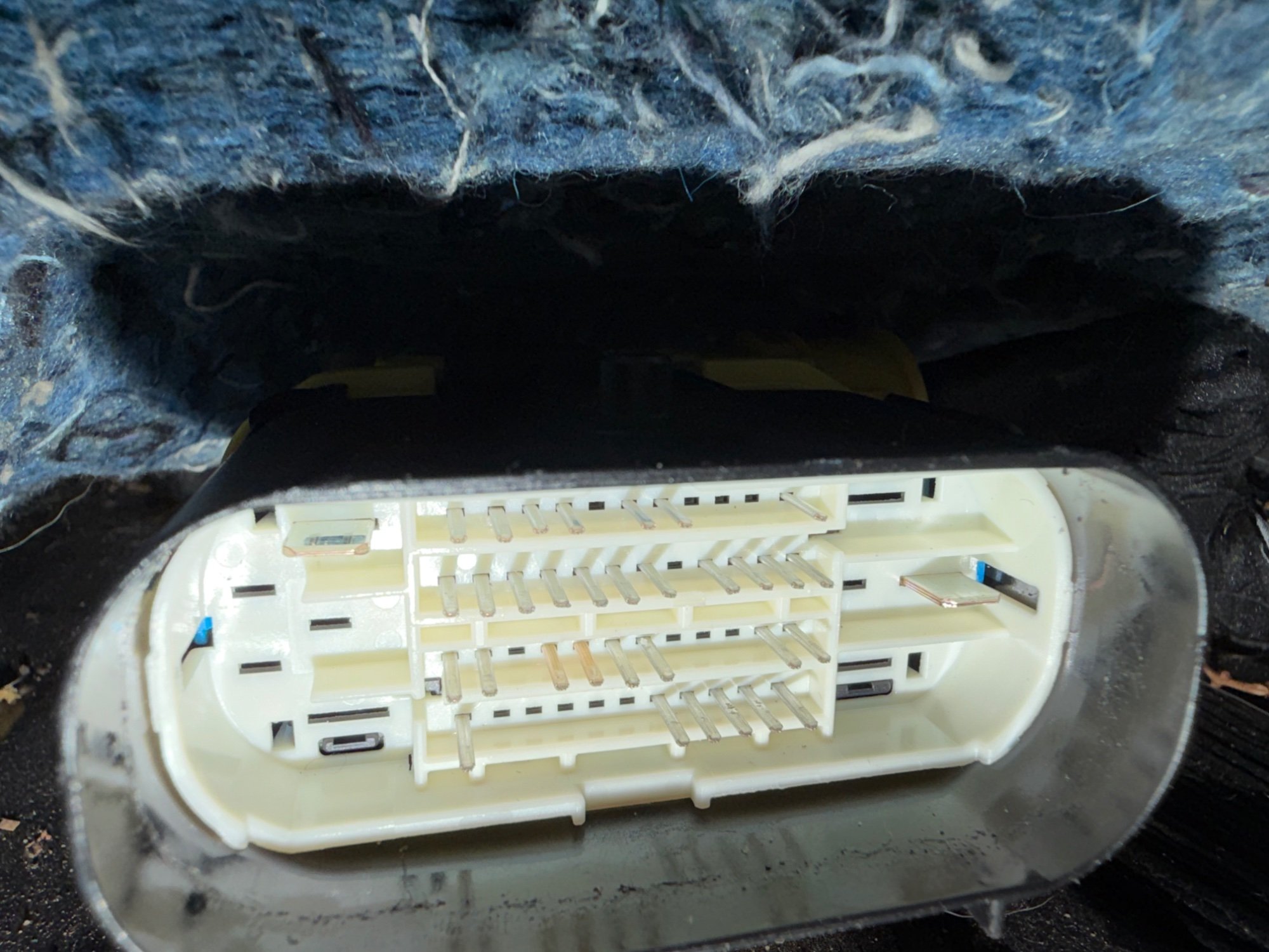

@Kyle W hey Kyle! Good news is the driver seat works! And first and foremost thank you very much for your help! My passenger seat on the other hand still does not, i checked my harness and two connectors that you pinpointed are there and one is missing.
@Kyle W my other concern is this is what it says on the harnessdr website, my truck is a 2022.5 i assume the refresh means the bigger screens and the new front end :
Fits:
2019 – 2022: 1500 Silverado/Sierra Trucks
2020 – 2023: 2500HD, 3500HD Silverado/Sierra Trucks
Does Not Fit:
2019 LD (carry over 2018 K2XX): Silverado/Sierra Trucks
2022.5 “Refresh” – 2023+: 1500 Silverado/Sierra Trucks
2024+: 2500/3500 Silverado/Sierra Trucks
@HHHlet's go!!! So glad you got the driver side working! So it may be different on the refresh truck so let me do a little research quick
