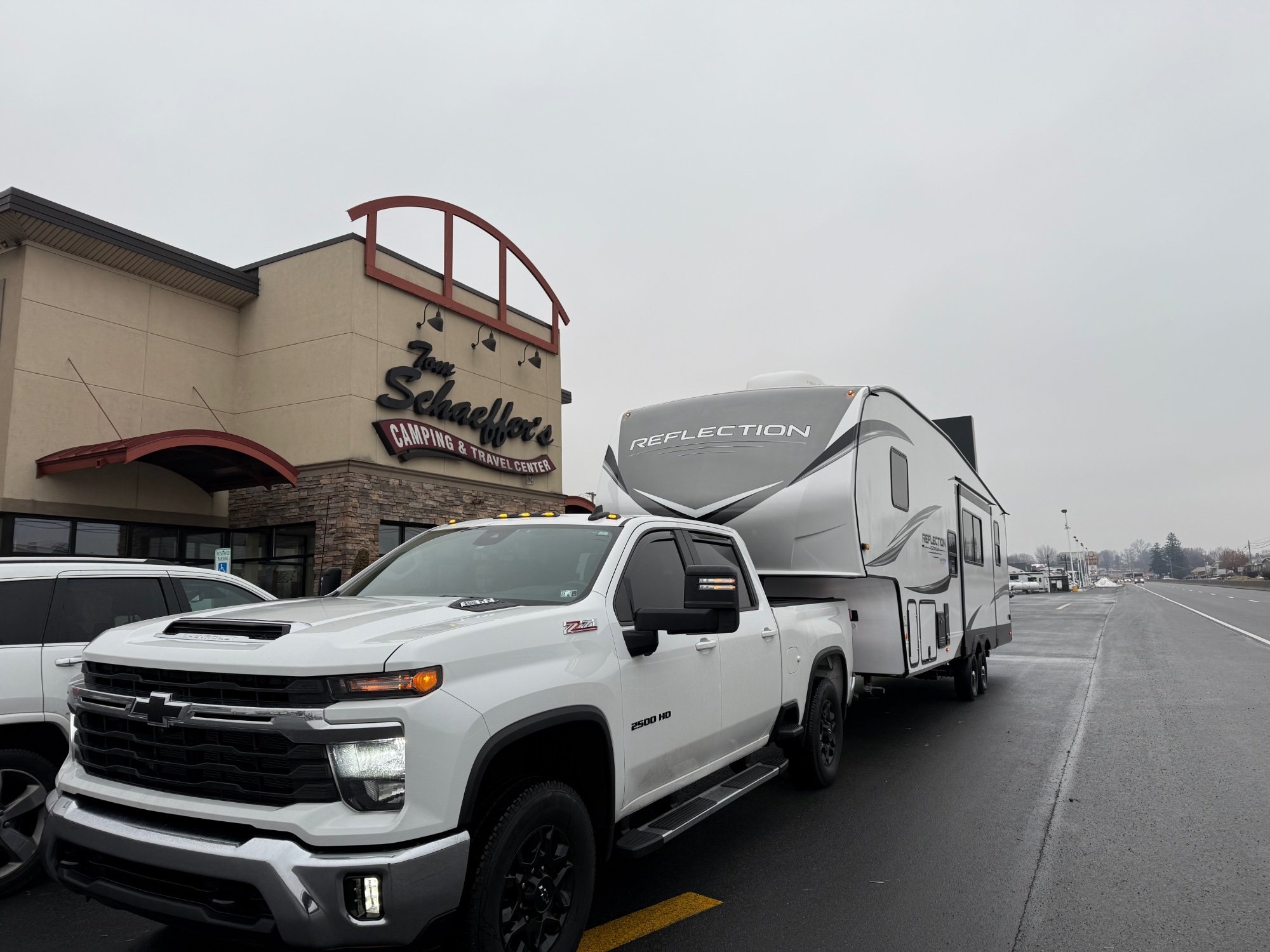

My issue is chucking.  Everyone has commented that it must tow way smoother than a travel trailer, but my experience has been the opposite.  Any irregularities in the road surface, any acceleration/deceleration causes the truck to have a push/pull feeling.

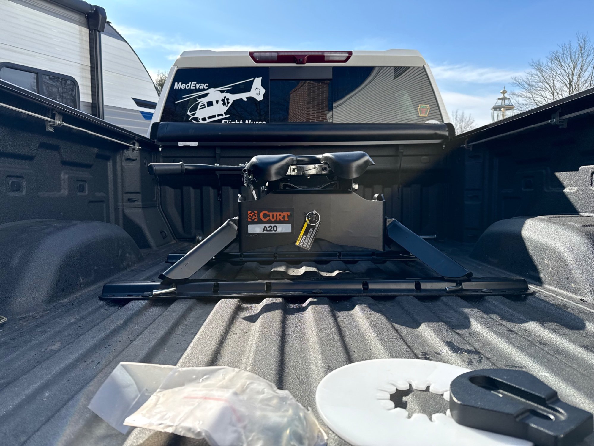

I am looking for potential solutions.  I’m going to shim the feet of hitch with rubber for isolation and take any slop out of the rail connection point.  Would airbags for the truck help?

Looking at your first picture, your 5th wheel is quite a bit out of level. The nose looks noticeably higher than the tail. I would lower the hitch head (not sure if the curt allows for that) and/or raise the pin box so that it sits level. That may help smooth out the ride and you still should have sufficient clearance.
The front of the camper should be 6" above the bed. Yours looks higher. Also, have you actually measured pin weight at a Cat scale? Specs are dry weight, add all your gear, propane, batteries, etc. Granted, your 3500 should handle it fine, but you'd be amazed how fast it adds up! I plan on bagging mine for my 5er we're buying.

I redid some measurements now that we are loaded and on level ground and found the rail to camper to be 8 inches, dropped the hitch 2 inches, also greased every connection point on the hitch itself and now have much more flex of the head.  Looking forward to the ice going away so I can give it a test tow…

Does your hitch rock in the bed rails without being hooked to the rv?  You need to get that play fixed.  Loosen the bolts and press on the hitch to get it settled, then slowly tighten the bolts. I have had others tell me to hookup to the rv and then Loosen the bolts. The weight will hold the hitch down to tighten it. Just make sure the tow vehicle and the rv are not pushing or pulling at each other. Need them relaxed. That's why the puck system is a little better. You have adjustments on each corner.
I don’t have screws bolts that hold it to the rails, just pins, I did shim the attachment points, but need a thinner one to add onto..1 layer isn’t quite enough, 2 is too much of course
No, the bolts that hold the legs to the center section. You have the same hitch that I do. But I have the puck system legs. There's 2 or 4 bolts on each side. I can't remember if they take a 3/4" or 1 1/16" wrench. I think it's the 3/4" wrench. The 1 1/16" wrench is used on the pin box bolts, I think.
