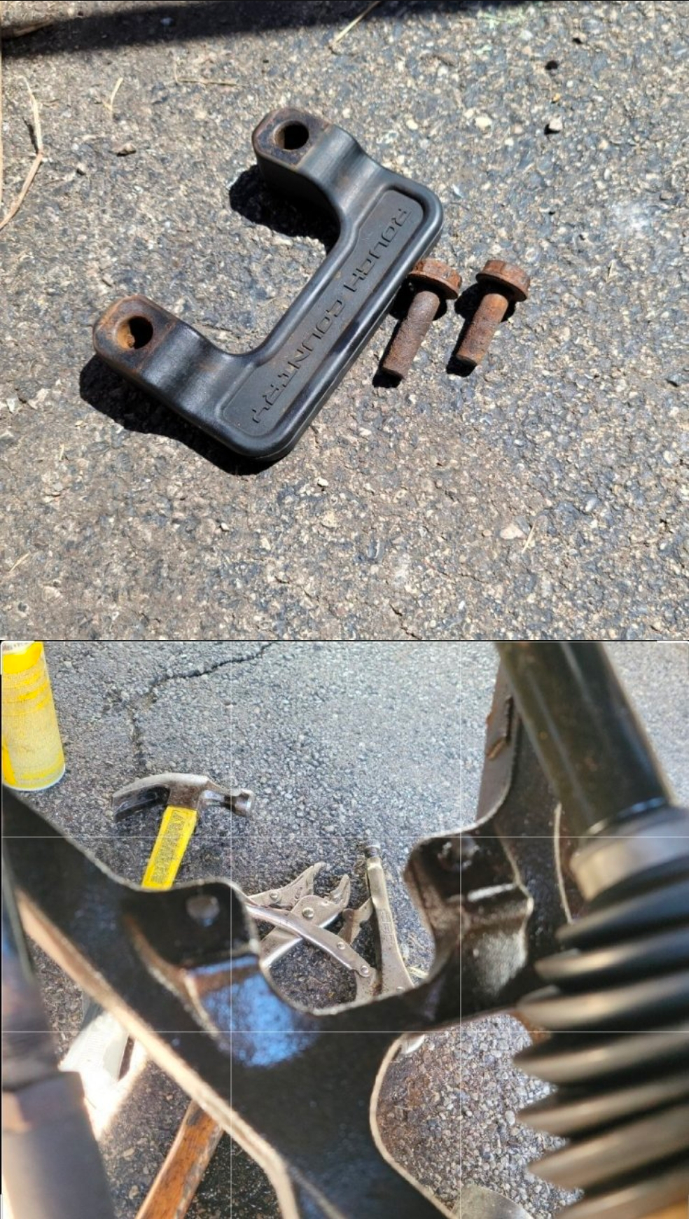

I think getting rid of the lower Rough Country spacer is a positive move no matter what you do. I put on the spacers on my 2016 in Sep 2019. In 2022, I decided to remove them in favor of Rancho Quicklift struts. It was a nightmare. The bolts that hold the bottom of the struts on were heavily rusted. With some extra effort, I was able to fully remove the right side but the left side was even worse. I got the nuts off but the bolts were stuck in place. I ended up snapping off both bolts in the middle.
I had to drill them out. I even tried using penetrating oil and let it sit on them for some time but no dice. If yours is anything like my experience, you're in for a "fun" time.

    • Thanks for the description and pics of the removal of the RC strut spacer.  Can't wait to fight that battle 🫤

  • At least the access should be pretty good to get at the bolts/holes. I'd replace the hardware with stainless if you can get stainless in the proper grade. The bolts on my past truck corroded pretty badly too, they didn't seize in the hole though.
