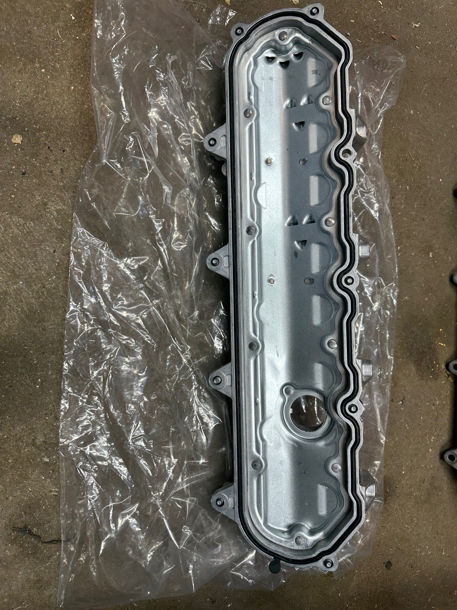

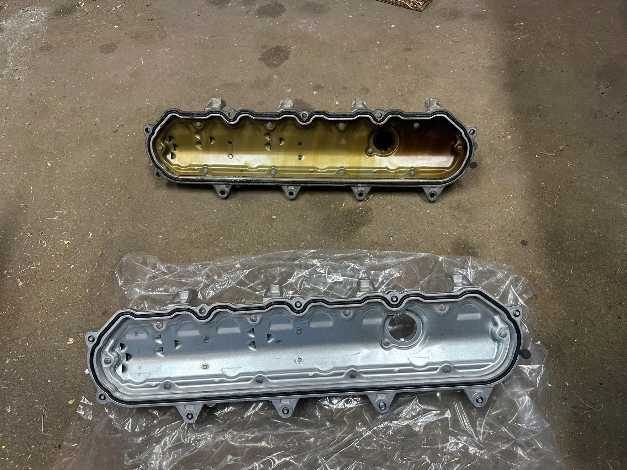

I’ve ordered replacement valve covers.  It seems the numbers have been updated multiple times and the covers are the same as the next version of 5.3/6.2s.
I’ve only installed the drivers side so far but I wanted to show you my old
cover vs new. Not much difference but it seems the old cover was bypassing the baffles and sucking oil / vapors right into the airbox.
it seems GM changed some of the rivets in the middle of the baffle to maybe hold more pressure on the edges against the cover.  I’m going to drill the rivets so we can see what’s under the baffles.
has anyone dealt with this much oil consumption / valve covers / updated part numbers?

Here’s one more of the new drivers side cover.
will upload pics of the passenger side when I swap them over.

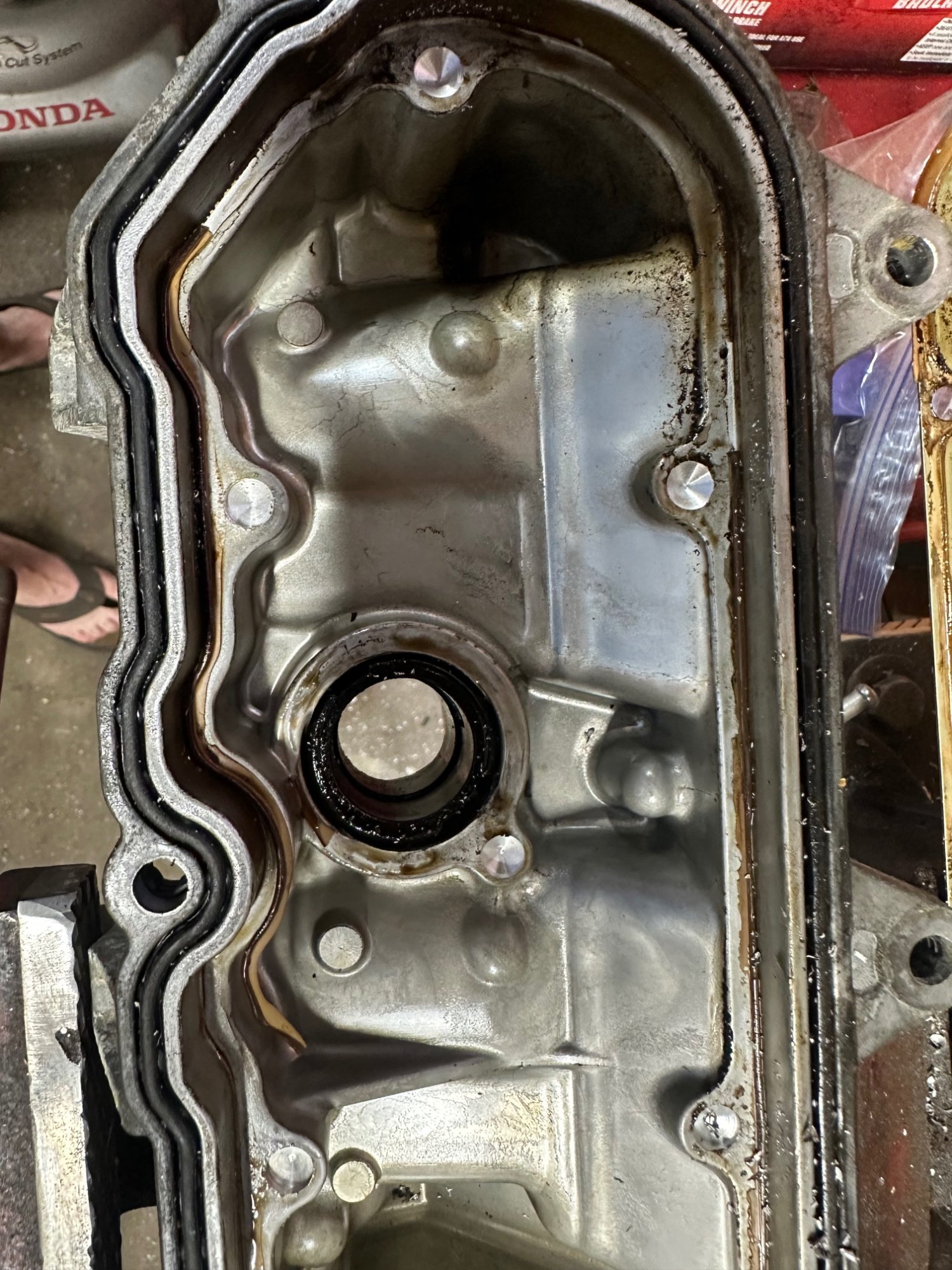

also here’s my passenger side cover when the lifter collapsed at 145k in November of 2022.

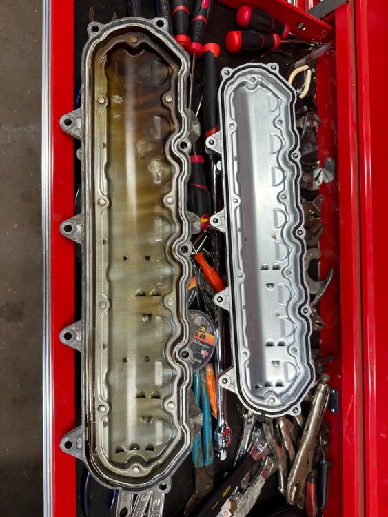

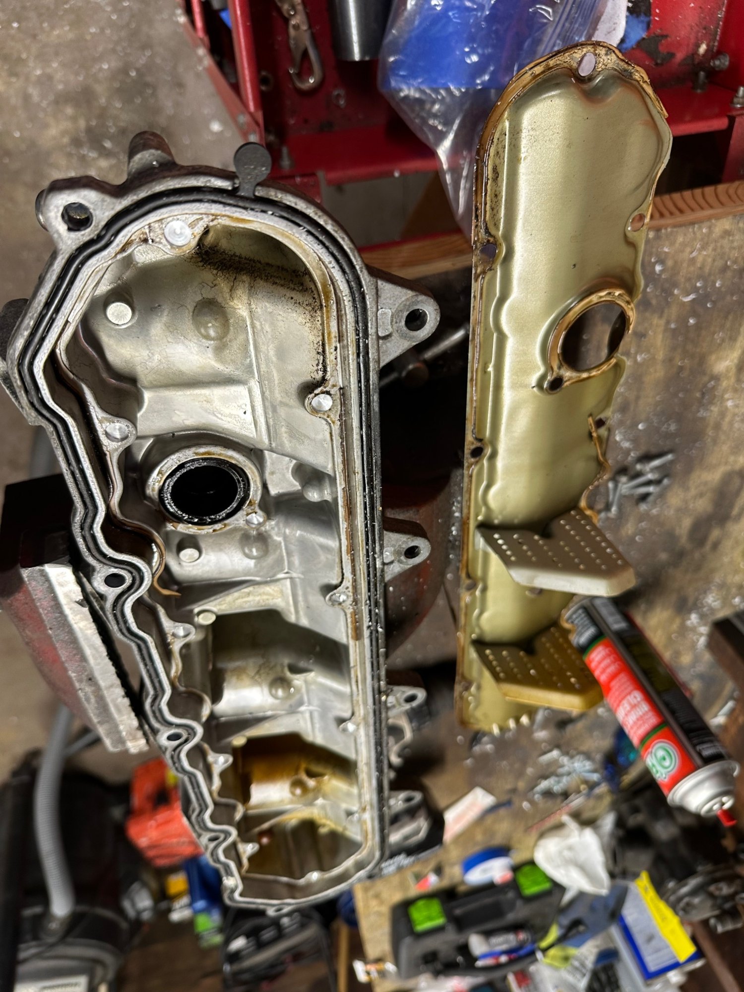

I tore apart the old driver side VC. There’s a sealant between the alum valve cover and steel baffle assembly that’s riveted down.  It seems the seal let go near the port that goes to the intake / before the throttle body.
The design looks like a sealed side that sucks from the air intake and pulls from 3 / 6 holes and then internal baffles seperate the oil / vapors from the air and then drain back down and drip to the heads.
Once that seal fails, oil will be sucked up right into the air intake / before the throttle body. It won’t pass through the separators and you’ll burn more oil. Add in the fact that both valve covers could attribute to this and you may end up with significant consumption, especially when you add in the amount of miles.
I do not have a brand new valve cover to tear apart to see what they changed inside the cover. Part of me wants to waste the $75 but that’s 6 quarts of oil if these fixes don’t work lol.
see pics of drivers side cover pulled apart.

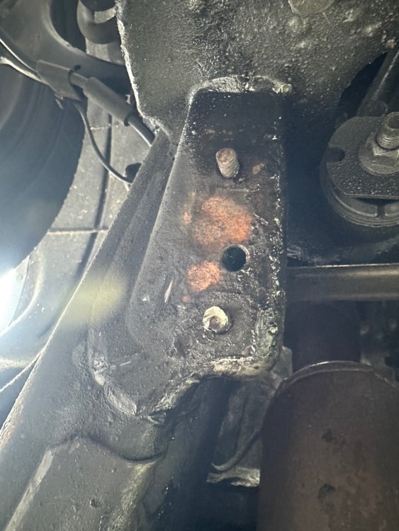

on another note - went to do sway bar bushings and 3 of 4 bolts broke. Gotta love New England.
