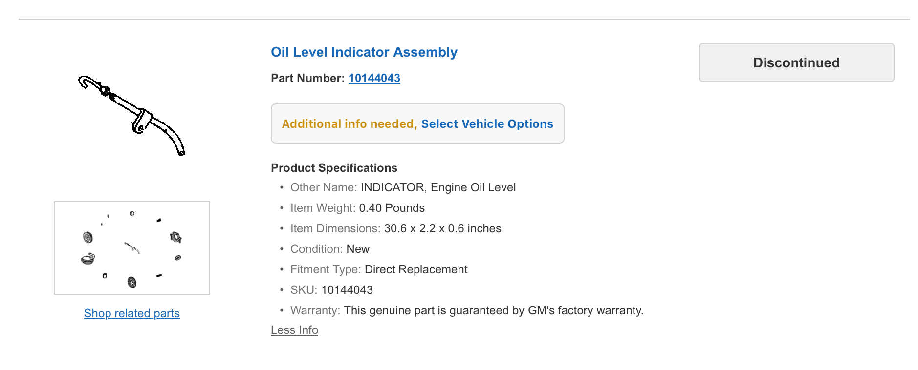

The original GM part number appears to be 10144043 and the stick (not including handle) measures 27" long.
Here is from the GM parts website. Dimensions show as 30.6" but I believe that to be the full length of the stick including handle.
