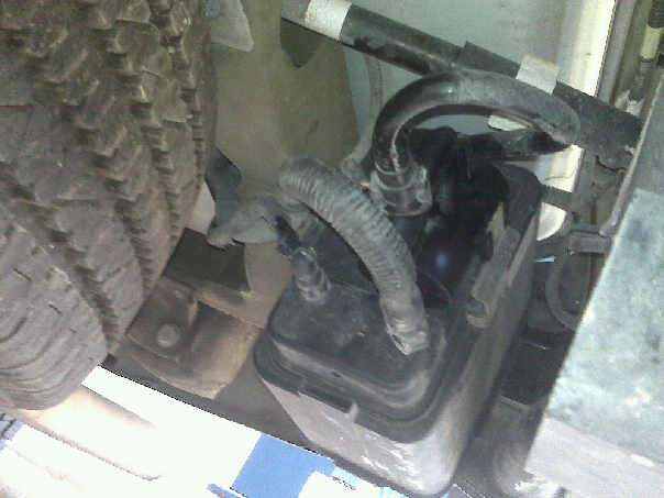

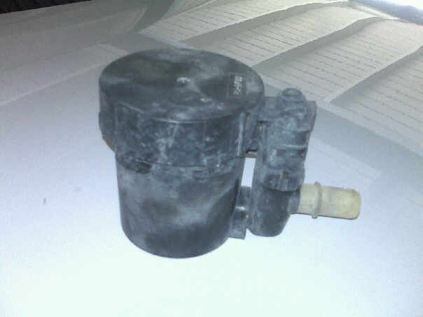

Howdy Thors, The vent solenoid is located behind the spare tire next to a good sized plastic box. Mine was dirty and dust went everywhere when I pulled it out. It is cylindrical in shape maybe three inches high. It has a black flexible hose and one electrical plug on it. See attached pics.
The purge valve though is up under the plastic housing on top of the engine. It has one small bolt that has to be removed, and again one wire. It is very readily accessible and can be replaced in less than five minutes. From what I have read for the P0449 this is the more likely problem, but since my evap vent was so dirty I'm glad they were both changed. See the attached pic. It's small and oddly shaped, but really is easy to replace.
Let me know if these aren't clear enough and I can email them too you.

My 2005 Colorado has a P0449 code and dealer said problem is faulty evap vent solenoid; part # may be 10386359 but not sure; next question is "where is the solenoid located and is this the part # correct" ??

An update: I found the vent valve and solenoid exactly where yours is. Your pics made it a snap in identifying the right part. Off to the dealer tomorrow. Will keep you posted.

Hello everyone, I just wanted to add one thing from my experience.... I have a 2006 silverado 1500 and the items were in a similar place to the ones mentioned above... the one under the plastic covering of the engine is up front and easily removed with one bolt... i used an 8mm socket and it came out simple. The other piece is next to a plastic box as mentioned before only, that it wasn't next to the spare tire... it was about 1-2 feet up from the driver side rear wheel. Its right up against the frame. Pretty easy to remove also. I'd suggest using a jack to lift the truck a bit so you can get a good eye on it. If you have nerf bars, your going to need to lift it a bit. 2-3 inches should be enough to get a hand on it and maneuver around a bit. Hope this helped anyone else that needed help finding this crap pieces which are now mandatory on cars/trucks. Good luck everyone.
