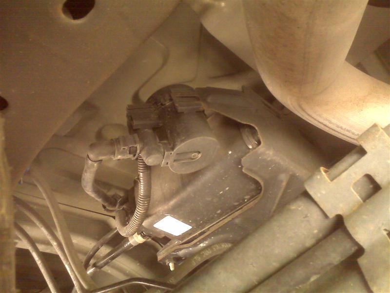

Howdy Thors, The vent solenoid is located behind the spare tire next to a good sized plastic box. Mine was dirty and dust went everywhere when I pulled it out. It is cylindrical in shape maybe three inches high. It has a black flexible hose and one electrical plug on it. See attached pics.

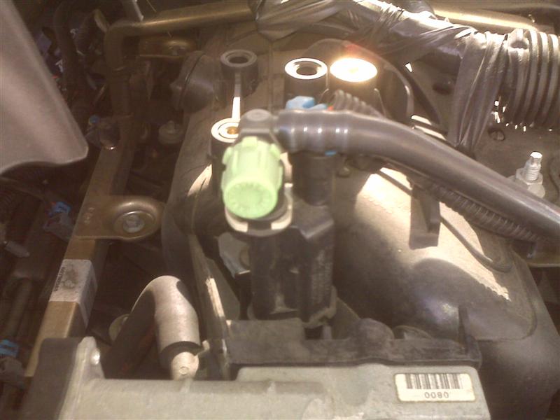

The purge valve though is up under the plastic housing on top of the engine. It has one small bolt that has to be removed, and again one wire. It is very readily accessible and can be replaced in less than five minutes. From what I have read for the P0449 this is the more likely problem, but since my evap vent was so dirty I'm glad they were both changed. See the attached pic. It's small and oddly shaped, but really is easy to replace.
Let me know if these aren't clear enough and I can email them too you.

Thank you so much Jared my 2006 silverado had the same code replaced both and everything is good,thanks also for the pictures helped a baunch.
