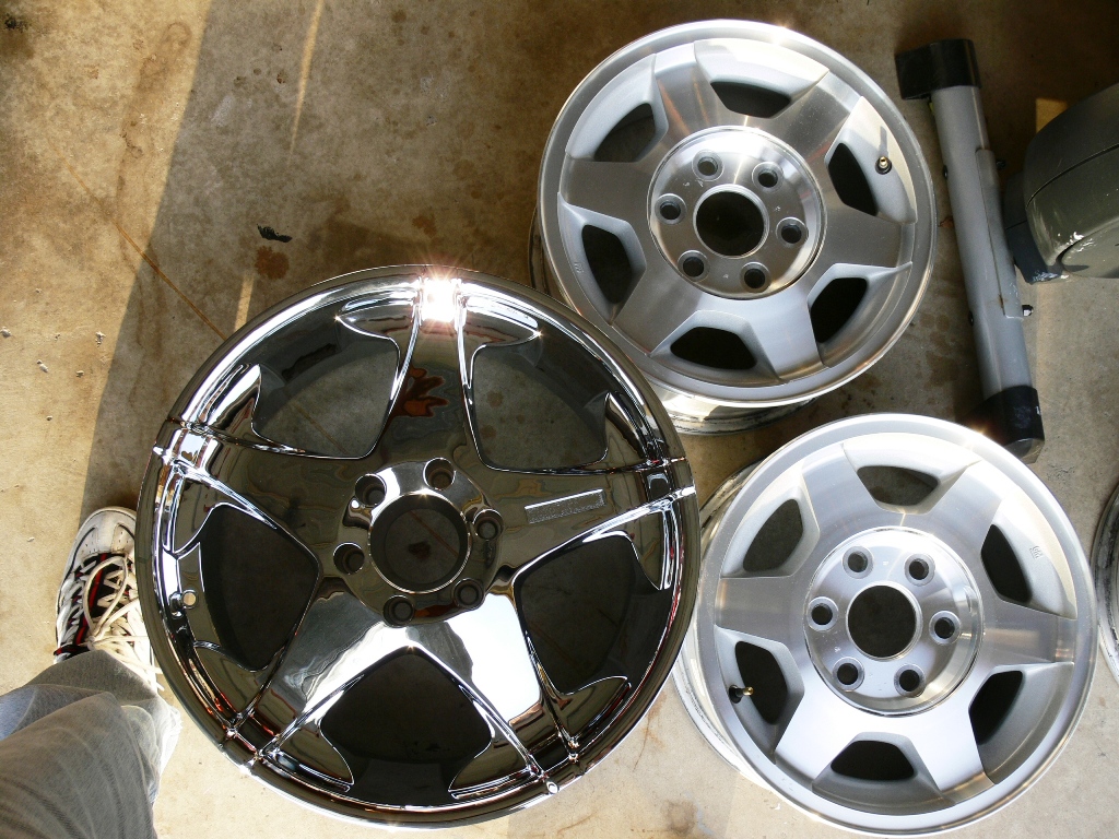

I know that bigger brakes are needed, what about the suspension? Adding all that additional weight can't be a good thing. In case you missed my other post, the stock aluminum 16's weigh about 15 lbs and the chrome 20's weigh about 40 lbs.
Brakes will survive fine as long as the overall diameter of the tire and wheel package is not much different. Just be ready to stop at the gas pump more often... Those heavier wheels will drop your MPG by a mile or two. Mine did... but it was worth it.
You had a suspension question too, again nothing needs to be done(if you like the way she looks now)rims are unsprung weight. Unless you get some that stick way out like in the 90's.
