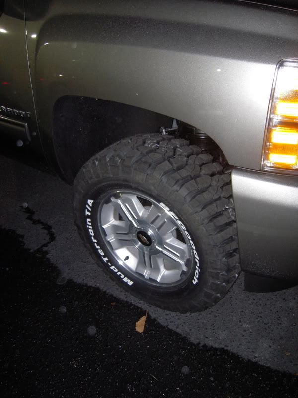

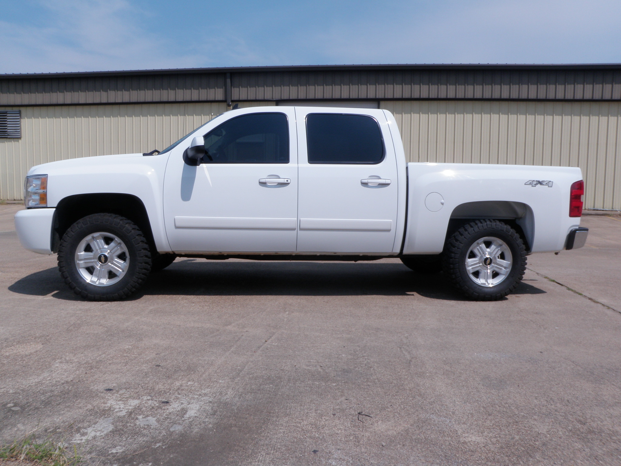

here is a 305 60 on the Z71 18s that is leveled 2 inchs and he said it didnt rub. I dont remember which forum i got this from but it looks pretty good....didnt realize how old this post was when i replied to it.

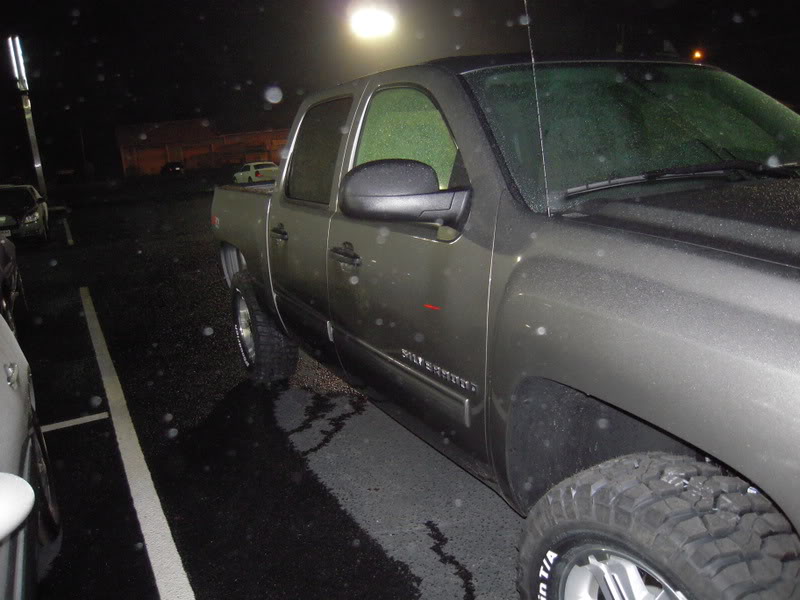

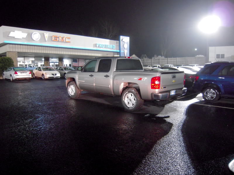

I have 305/60/18 BFG KM2's with a rough country leveling kit. I had to trim the plastic fender liner slightly but it was no biggy. I have about 10,000 miles on the tires now and still love them, and they still look brand new.
