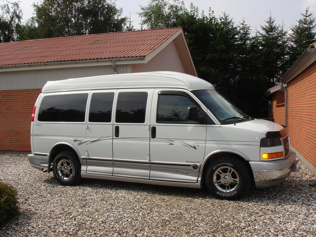

I have a 2003 GMC Savana 5.3 G1500.
When my A/C compressor is engaged, there is a lot of noise under acceleration... *I discovered that the tensioner was bouncing around, sometimes even hitting the oillines from the transmission cooler.
I've changed the tensioner, and it may have helped a little, but the problem is not solved.
Is this a known problem? If so, what will I need to do? If not, any ideas?
Any help is very welcome, since there is no GMC dealers in my country. I own one of perhaps 5 to 10 Savana's here in Denmark...
Btw. it's a Explorer conversion with rear A/C. Don't know if that matters?!?
