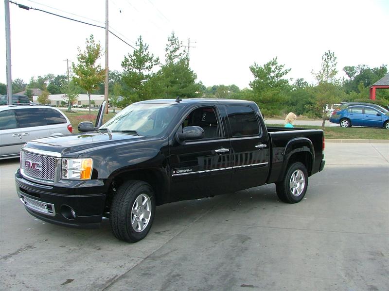

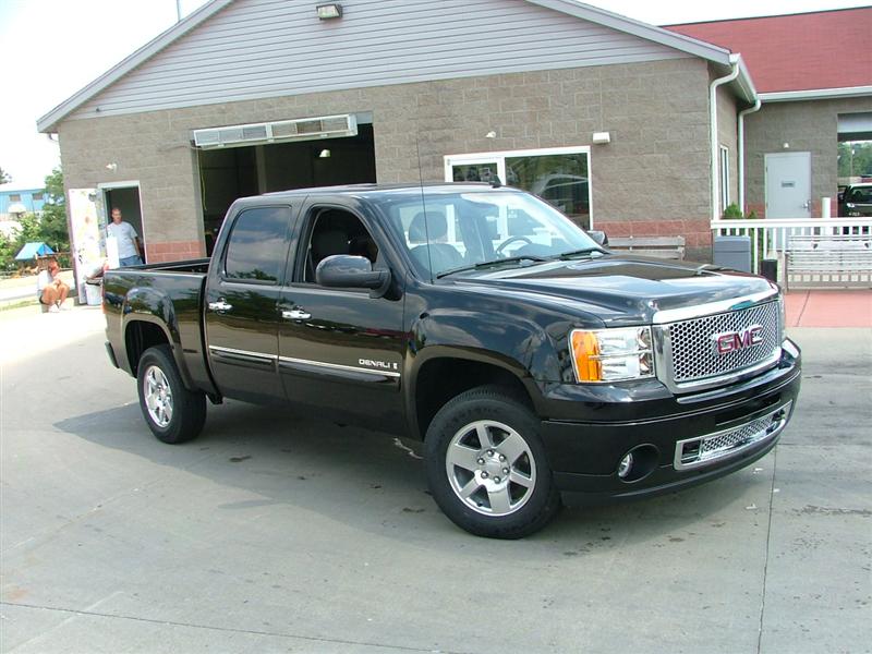

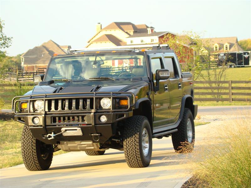

You can't just talk about your trucks like that and not give us pictures! :lol:
I concur, go with 4.56. I have 4.88's in my crawler truck with 37's. On the street it is just fine. I am adding 4.56's to my H2 Hummer, and will eventually put 4.10's in my Denali. The reason I don't go to 4.56 in the Denali is the 417 ft/lbs of torque. With that and the six speed, it has a ton (well a quater ton) of low end torque already.
My Denali will eventually get 33's with a 3" lift mainly for looks. No off road in it's future...
Yeah, WTF? POST THEM UP!!! :lol:
You can't just talk about your trucks like that and not give us pictures! :)
OK, OK...
Here's the H2, right after I completed the custom rear tire carrier
Not mentioned in my sig...but here is my crazy crawler truck. I actually drive it on the street also. I did it all myself including the 5-link SAS, bent all the tubing for the sliders, suspension, rear bumper, and roof rack, and so forth...Powered by a supercharged 4.7 Toy V8 with lockers front and rear, and 4.88's
