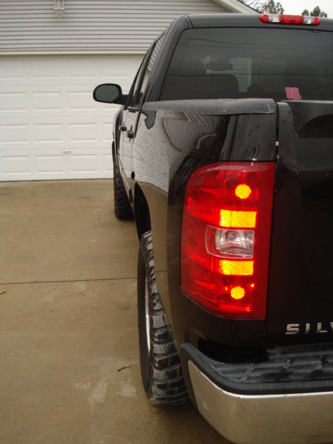

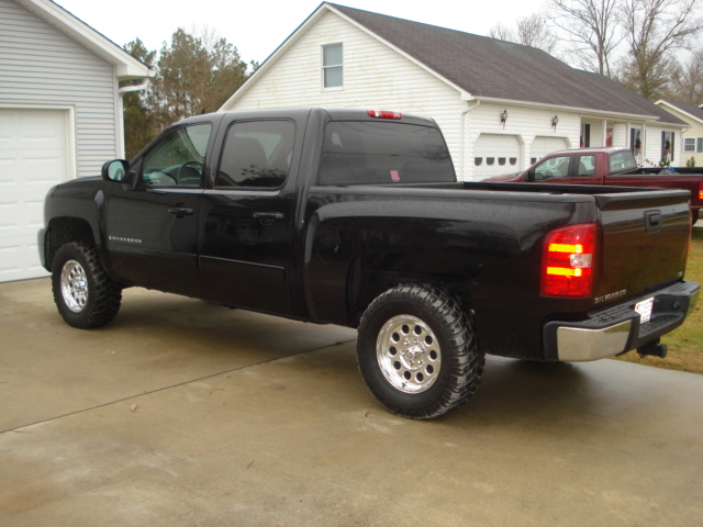

Here's a couple pics from my new tires/wheels and 2.5" top gun customz leveling kit. Wheels are Ultra's w/ 5.5" BS with 25mm offset, tires are 33x12.20x17 Mickey Thompson Baja Claws.
No rubbing, front height is 39.5" and rear is 39" to fender wells. Adding 2" more in the rear as soon as the block comes in.

Yeah,You definetly need to add those blocks,I had to do the same thing.
Its funny,You add a leveling kit to "level it" and the front ends up higher than the rear!

Looking good and NOT like everybody else's truck. :sigh:
That was my thought after seeing the wheels installed, and hardly anyone is running Baja Claws on the new trucks
