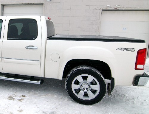

I had my wheel wells done at the same time I had the box done. I was charged $65.00 for each well. There was no over spray, they did a great job, should have done this on my other trucks.Picture shows how it looks from a distance.
