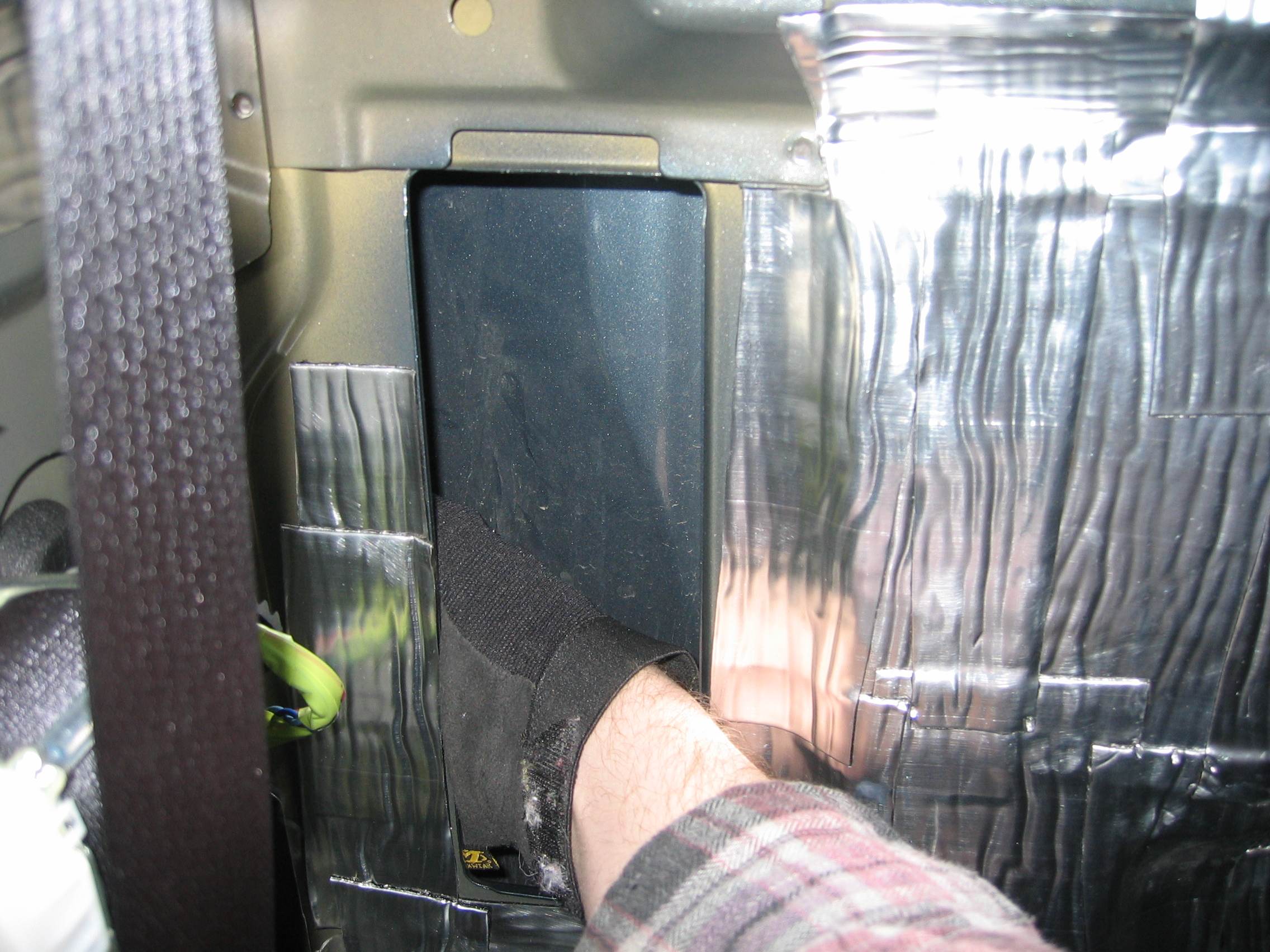

I took out the back bench and moved all of the stock deadener stuff out of the way and i found this plastic peice
which was in this hole
it is the weirdest thing i have ever seen, and i cannot for the life of me figure out what their purpose is. There is one on each side of the cab and if you look between your bed you can see the outlets of them.

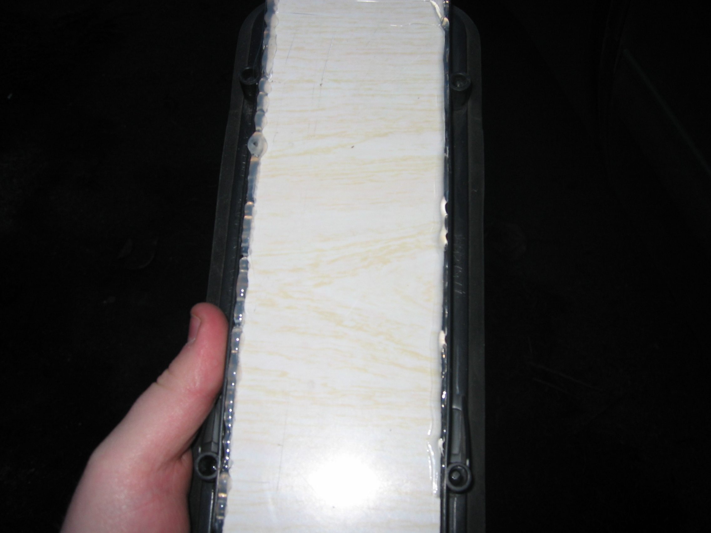

i decided i would rather not have 2 large openings in my cab so i spent about 4 minutes cutting apart an old table that was in the garage and putting them on the outside for the time being. These are temporary until i can figure out a better solution or figure out what they do.

should i not seal them off then?. i dont understand why they would put a vent behind a seat back and 1/2" of foam padding...i believe you i just dont understand why
Same reason they tell you to crack your windows for a few days after getting your windshield replaced so you don't pop it's seal before it fully cures.
Vents, you should see them flap open when you close the door.
When you slam your door you cause a very big pressure spike and the vents give that pressure a place to go. The back of the cabwall has been the place for these vents for many years.
Definitely do not seal them. When you have the AC or heat on, they allow air to go somewhere. Otherwise, it would just pressurize the cabin until it didn't blow any more. Those vents are critical to the HVAC system.
If you seal them off, you will have problems with air flow in the cab, such as, when you go to close the door, there will be pressure built up in the cab. The door might now close all the way.
If you seal them up, and slap a door closed there is a chance that you can damage the window seals due the pressure built up inside the cab. I had asked this question on my last Sierra, and that was one of the reasons the vents are there. Good question though.
So, do you really need one more person to recommend not sealing them? Ok! Don't.
