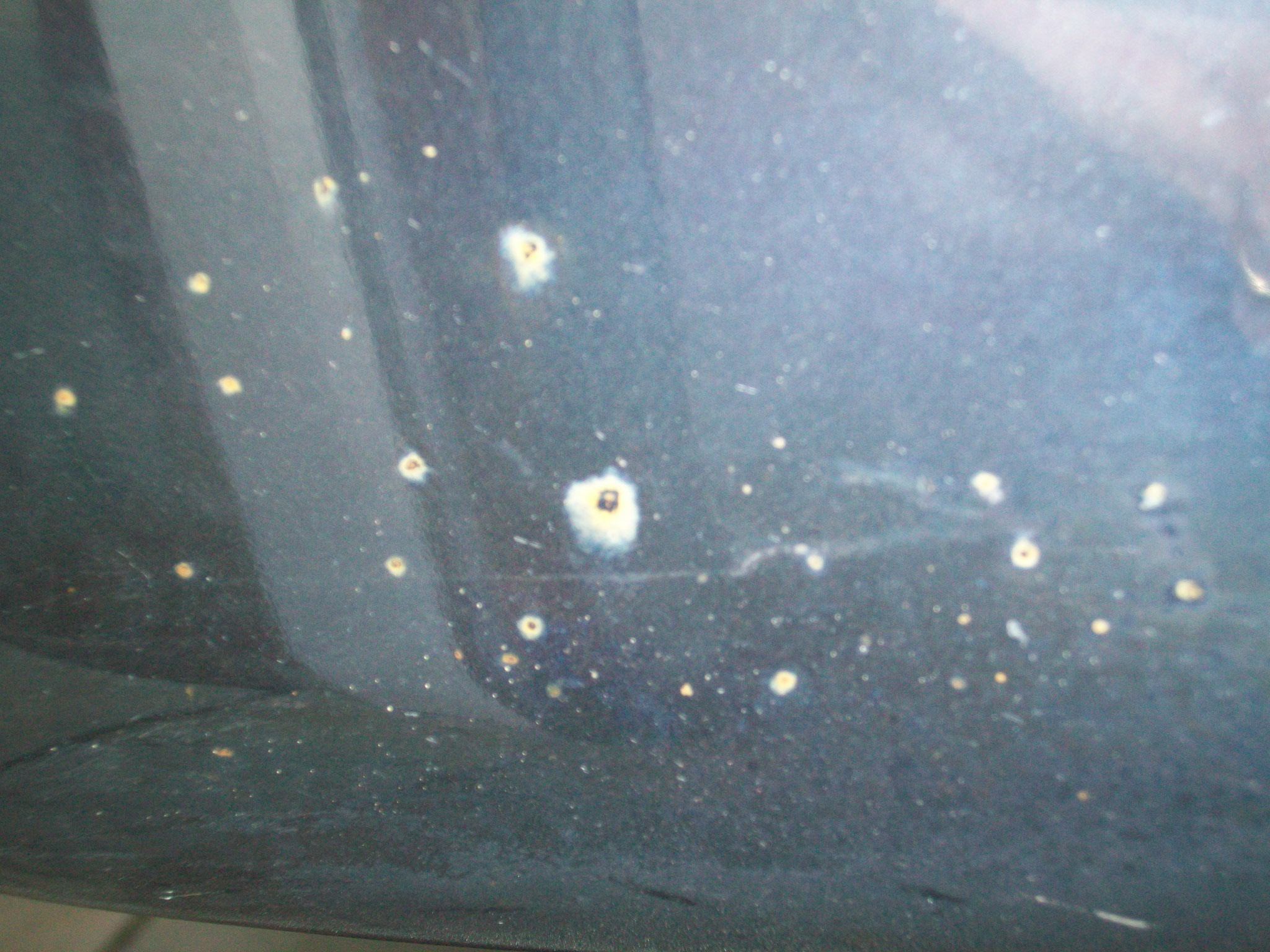

I would like to see exactly what you are talking about. Mine leaves a "bluish" spot on the bumper - but not yellow, or small pitted spots - more like a cloudy blue patch.
