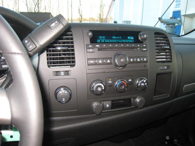

I have the Peripheral PXAMG in both of mine and it works great with steering wheel controls. Sound is awesome and keeps the ipod charged. I ran the cable to inside my center console, so it is like a built in music libary. Very nice.
I just installed the Peripheral PXAMG with HD Radio tuner add-on in my Sierra. I ran the cable into the upper glove box (SLE interior) and use a Bracketron mount to hold the iPod. The steering wheel controls work great.

Yes, the PXAMG one does allow it. I have that one in my truck, I got it from Best Buy and it was about $150. Works great and the added ability to use the steering wheel controls is nice I will admit. When you change sources on your radio basically the PXAMG replaces the XM1 and XM2. You still can use your XM, the adapter kinda adds a "submenu" to replace the XM source. So once you switch over to XM1 or XM2, you enter the submenu and can select XM1, XM2, iPod1, iPod2, Aux1, Aux2, or HDRadio. iPod2 streams from the same iPod port, but allows you to control strictly from the iPod itself.
