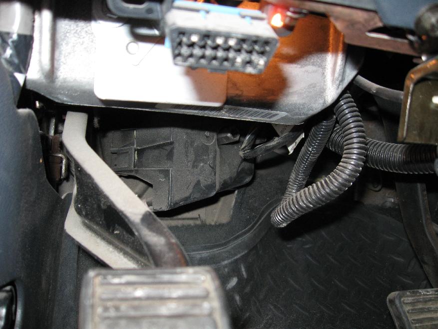

here is one i put on my 2001 2500 hd its a drawtite nodel 5500 electronic control .of course i bought the truck new so the adaptor came with it remove the cover under the emergency brake pedal ,buy unscrewing the plastic hex nut on the cover ,after you attach the adaptor to the controller mount the control and plug it in .it goes were the brown plug is on the top in the picture ,replace the cover .if you need the plug center pole hot for 12 volt power source for a trailer break away ,you will have to install a 40 amp maxi fuse if there was never a controller on it before with a breakaway or for lights inside a camper it should go were my finger points to and it will make the factory 7 wire plug hot

mine was in the glove box ,some were in the console . if you bought your's used it was probably taken out ! they changed the pin location in they plug in 03 so get one for the 01other wise it will reverse some of the function's .
